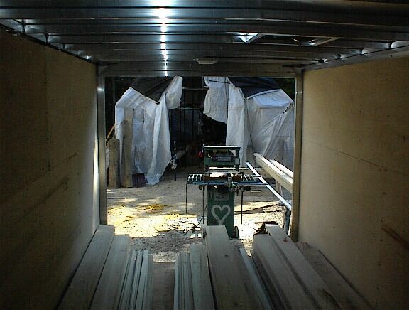

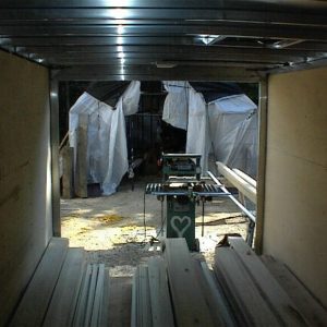

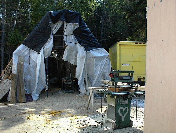

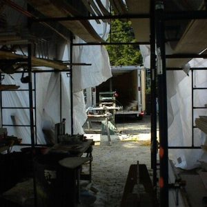

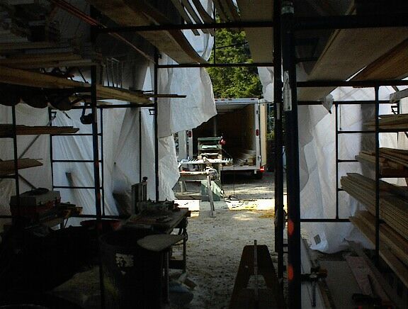

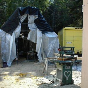

          21. Piffin | Aug 17, 2008 11:56pm | #29
            Shop?Nine times out of ten, my job has been big enough to set up shop right on site. Saves time running back and forth and Ican be there to meet sub, supervise things, and do millwork same place same time. Here are some set up on site. The job before that had a large basement space that I commandeered as a shop.Cabinets do get built in a normal shop space though.
          22. DougU | Aug 18, 2008 06:06am | #30
            What the hell Piffin, you painting hearts on all your tools? or just your favorite ones.
          23. Piffin | Aug 18, 2008 02:28pm | #31
            LOL, I was telling somebody I love my work as I happened to be ready to clean out a paint brush. Sometimes I talk with my hands too! That 1/32 of Italian comes out in me.
