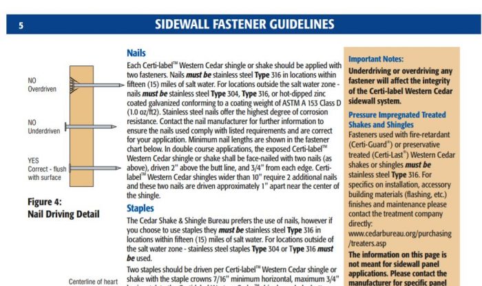

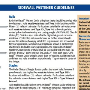

    The Cedar Bureau states that stainless or hot dip galv. are both acceptable. If it were me I would go with stainless.
