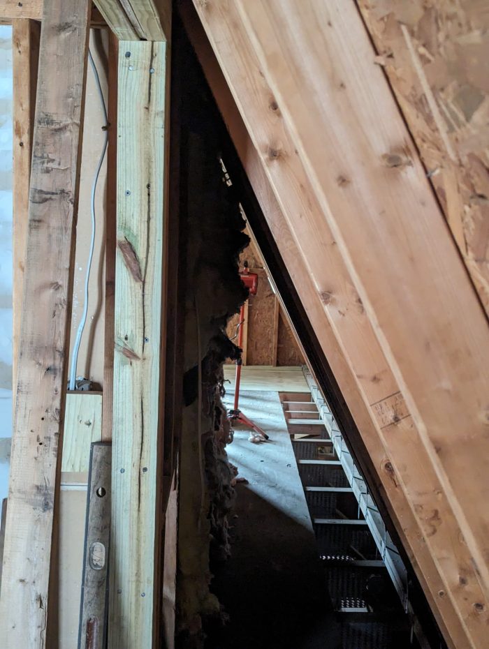

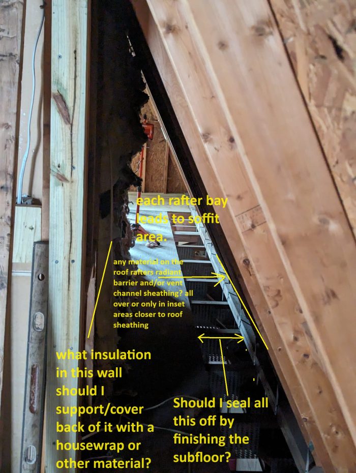

wow 2000.. 24 years later I'm looking for similar answers.. I have a gambrel that has upper attic vented by gable vent on each end and ridge vent.. the side attic area does have a 1.5" gap at top plate allowing air to upper attic.. I have a 8" soffit board that was not vented but was not sealed properly so must be sucking air through seems as I can see light. this could be vented
I am looking for best way to provide vent channels & insulation in areas where I am taking out 2x4 studs and pushing my wall closer to the side roof slope. was considering foam board on side roof sloped rafters to provide radiant, R value, and also create vent shoot/channel. this would lead up above the top plate where I would put vent baffles at the roof break/transition in the upper attic to ensure that insulation does not cut off the ventilation.
then I need help in best insulation in the rest of the walls where they are vertical creating a knee wall/side attic area situation.. what type of insulation is best inside the 2x4 studs and then should I put something on the BACK side of the studs to protect the insulation from wind washing and add R value (foam board) or is this creating an issue?
