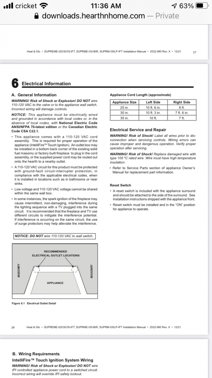

The manufacture and the local installer wants an unswitched outlet installed in the right back corner of the masonry firebox. His electrician does not like it and and after he told me I don’t either. It does seem to be a NEC code violation.
I would take an inset to be a permanently installed device. The insert comes corded, is not set up for direct wire.
I don’t see how the outlet could ever be serviced with out removing the whole insert. There is only a 2” clearance on the bottom of insert and existing hearth. And a bit on the sides.

What I do not get is this insert is a major manufacturer, superior heat and glo. Their electrical requirements seem to violate NEC code. Yet they tell one to follow all NEC codes or Canadian codes!
