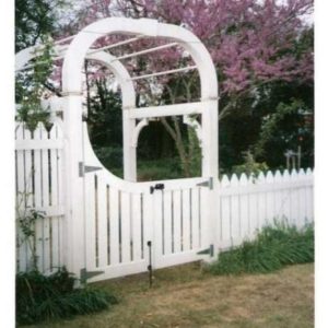

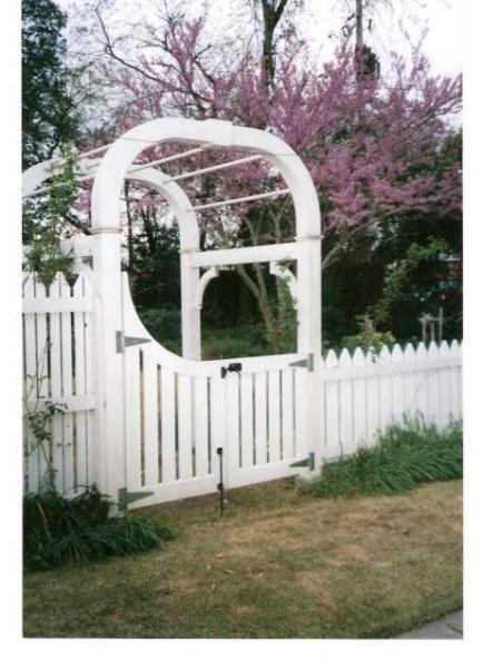

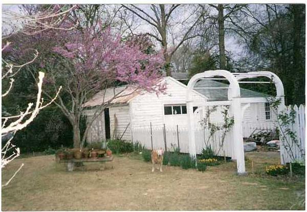

I’ve built my share of simple garden gates.  But I often see gates built on a higher level of craftsmanship and detailing.  I’ve searched the bookstores, but find very little written on the subject, as most books are more generalized in approach.  Could any of you talented craftsmen here share some in-progress photos and construction joinery / details for fine garden gates?  Thanks in advance!  – Huck
“…craftsmanship is first & foremost an expression of the human spirit.” – P. Korn
bakersfieldremodel.com
    Huck | May 10, 2009 05:37pm | #1
    "...craftsmanship is first & foremost an expression of the human spirit." - P. Korn
      Huck | May 10, 2009 05:43pm | #2
      View Image"...craftsmanship is first & foremost an expression of the human spirit." - P. Korn

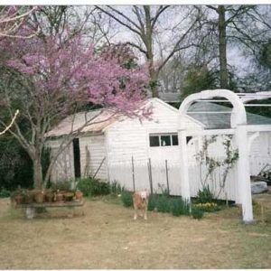

        Huck | May 10, 2009 05:46pm | #4
        Not a good photo, but this is typical of the gates I have built.  Z-shaped 2x4 frame with 1x4 fence boards.  I have never built an "architectural-grade" fence.  Love to know how.View Image"...craftsmanship is first & foremost an expression of the human spirit." - P. Korn

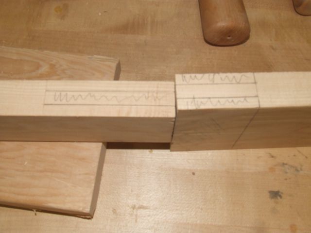

          9. User avater

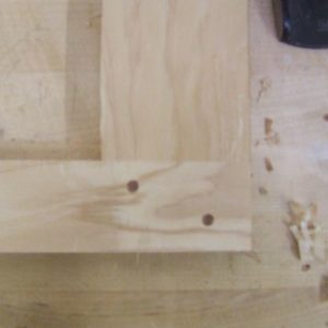

            Huck | May 12, 2009 03:15am | #36

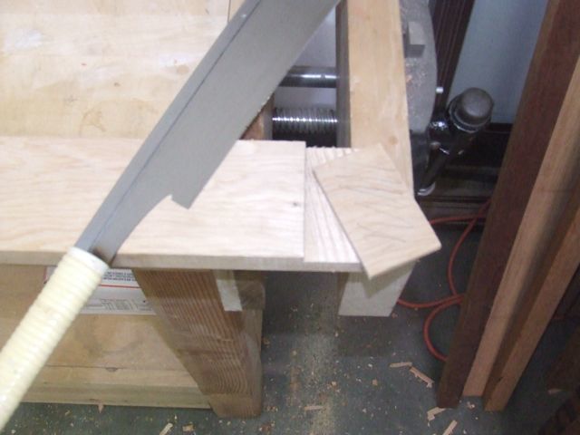

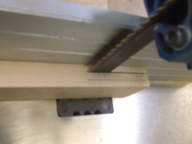

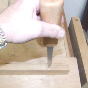

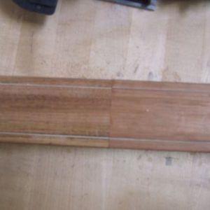

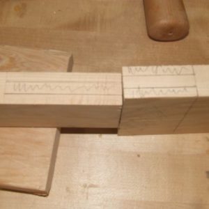

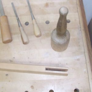

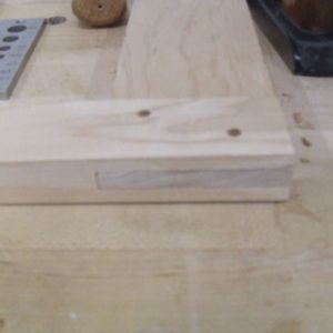

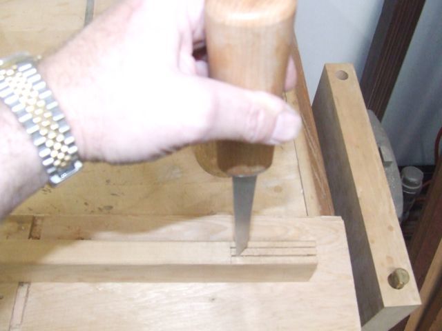

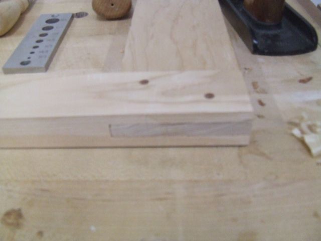

            ok, this is pretty amateur, but I thought I'd just give it a try, to get something going.  I've been thinking about this for a loooong time, and keep procrastinating because of not being sure how to proceed.View Image"...craftsmanship is first & foremost an expression of the human spirit." - P. Korn

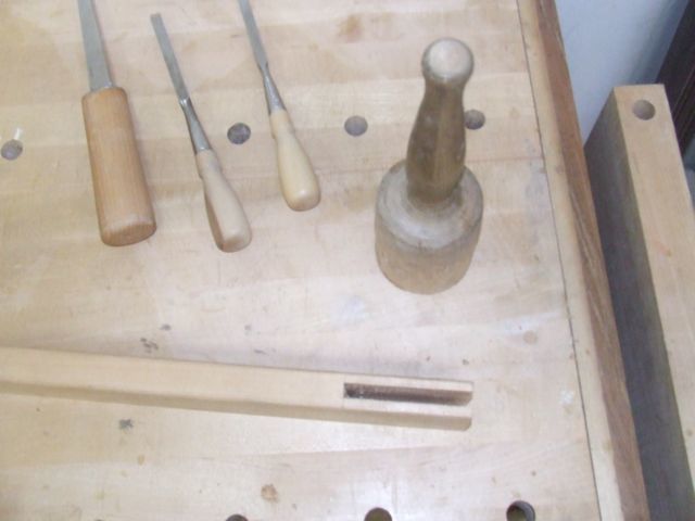

          10. User avater

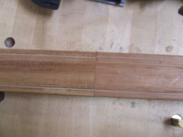

            Huck | May 12, 2009 03:17am | #37

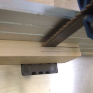

          11. User avater

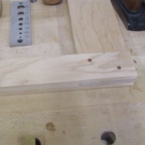

            Huck | May 12, 2009 03:17am | #38

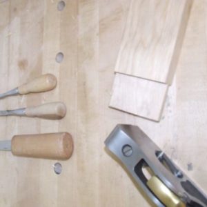

          12. User avater

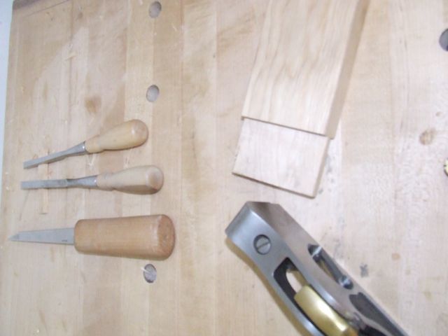

            Huck | May 12, 2009 03:18am | #39

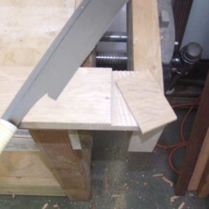

          13. User avater

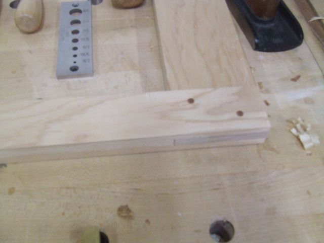

            Huck | May 12, 2009 03:19am | #40

          14. webted | May 14, 2009 01:26am | #48
            Nice job Huck - looks like you got it on the run. Here's my .02M&T is superior to floating tenons (Domino or any other) because only one of your two pieces is going to hold water. A floating tenon has two mortises that can collect water.For long lasting construction, a regular M&T beats bridle joints (even pinned bridles) hands down, for the same reason - easier to keep the water out. Titebond III is pretty good, but I prefer West Systems epoxy - it takes a little more work to make it up, and sometimes you need to throw some additives (usually silica) in there to give it some body filling, but it's pretty bulletproof.Of course, I'm on the wet side of the PNW, so shedding water 10 months out of the year is a necessity here.-t

            Huck | May 26, 2009 03:14am | #66
            Painting it with boat resin.  It'll take several coats, with sanding in between.  Like painting with honey - very gooey!View Image"...craftsmanship is first & foremost an expression of the human spirit." - P. Korn
          50. mathewson | May 26, 2009 04:03am | #67
            Huck,I see that you are in California, bridle joints will work just fine where you are. We get more rain in a month than you do in a year!Instead of drilling out all the small pieces between the vertical members you could clamp all the vertical members together and with a festool or skill saw make multiple cuts to remove material wide enough for the cross piece, half the thickness of the board. Then do the same thing to the horizontal piece making a dado cut as wide as you wanted the spacing to be.
          51. User avater
            Huck | May 27, 2009 09:09am | #68
            The first coat got all drippy - made for a lot of extra sanding.  I did some research on the internet, and found that, surprise, a 4" wienie roller is the best tool for applying resin.  So this coat came out smoother, and should require far less sanding.  One more after this should do it.View Image"...craftsmanship is first & foremost an expression of the human spirit." - P. Korn

          54. mathewson | Jun 01, 2009 03:50am | #71
            Huck,Took a couple of pics of some half-lap joinery which may work as an alternative for any future gates you make instead of drilling. In this case, being purlins they are not full half-laps but the process is the same.
          55. User avater
            Huck | Jun 01, 2009 04:30am | #72
            Thanks!  Can you tell me a little about this saw?
          56. mathewson | Jun 01, 2009 04:45am | #73
            It is a coarse cut Ryoba type Japanese saw from Hida Tools. I don't see it on their website now, but their website doesn't list many of the things they carry.Most any handsaw will work. I stay just on the waste side of the line and then plane to the line. It is reasonably quick and can be carried out in the field.

          75. User avater
            Lawrence | May 11, 2009 03:38pm | #33
            The perfect machine for cutting the female slot for tennons is a lockset mortiser.
            There are a few gates in our Fences section at http://www.gardenstructure.com but I have about 20 or so to post, including one that is blind mortise and tennon--pegged with keyless entry.
            Most of the gates are more knock together... most folks don't want to spend 3-10k for a set of gates. The other complication is the weather where we are based... we get roughly 100 freeze thaw cycles a year near Toronto--that is murder on joinery. We will normally seal all 6 sides to prevent water infiltration on anything "Fine".
            There is a whole section of gates on our other site...however that has been out of service for 2 weeks now...
            Huck?  Did you actually design and build that gate??

      I think you mean this one. I used clear heart redwood. Mortice and tenon joinery.
      Driveway side.
      Yard Side with gates open.
      There is a BT'er with a garden structure website as a tag, but I could not find it for Huck. It was in the 'please comment on my website' thread.

  6. DrewatSawhorse | Jun 03, 2009 09:22pm | #89
    The one with the leaf detail is really great looking.
      Huck | Jun 04, 2009 02:26am | #93
      man, isn't it 'tho?  That's my goal - to someday build something that beautiful!
