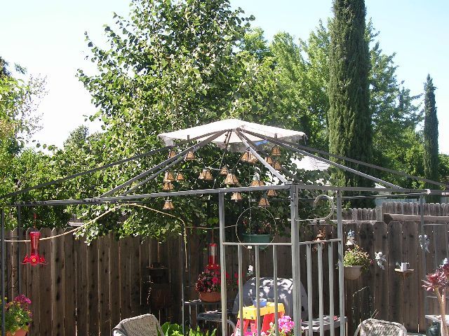

Anyway, 2 years ago we moved into a house that had a serious lack of shade in the back yard (hot, hot, hot!).  So as a temporary solution, we bought one of those $200 10×10 metal gazebos from Target.  So here we are 2 years later…the nylon cover it came with was torn to shreds from sun and wind exposure and the velco thingys that attach it to the frame had ripped off, but the frame is still in good shape.
So, I decided to try to sew a new cover for it.
I found some sturdy outdoor fabric at the fabric store, thank goodness it was on sale @ 40% off.  I was looking for fabric that had either a stripe or a plaid to make the “cutting-straight” part easier.  Unfortunately, they only had ten yards of that, so I had to supplement with a coordinating floral.
(I failed to take a decent “before” picture of the frame with the ripped up cover, but here is the frame.)
