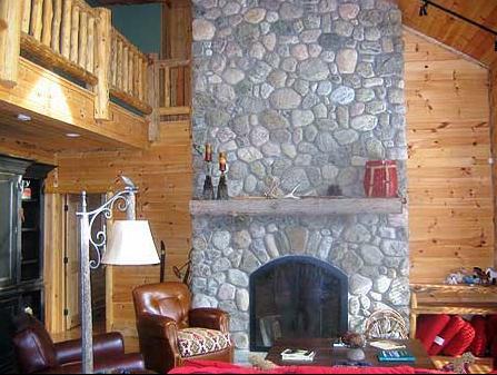

If you are having fireplaces built with some regularity, what’s your “plug in” cost number for a masonry fireplace.
You provide your mason with the foundation, he takes it from there.  Cap slab with cantilever, block core, refractory firebox, flue tiles, fieldstone facing, up through the roof, lead flashing, topout with poured concrete slab, standups, stone cap.
Something like what is in the pic, attached.  A tower roughly 8’x3′ in plan, 20 feet high, roughly 450 sf stone finish.
I am thinking somewhere in the range of $25K, complete, furnished and installed.
The reason I am asking is that I am trying to compare the cost to that of a woodframed chase, zero clearance insert fireplace unit, twinwall pipe flue, all decked out with phony stone lick-n-stick.

      Gene_Davis | May 09, 2009 05:03am | #4
      It's shorthand for doing the top-of-chimney style seen on over three-quarters of what gets done today, in these here parts.
      Pics attached.  The top of chimney is capped with a poured-to-a-form slab, and stiff mix is used so its top is given a little pitch like a very shallow pitched hipped roof.  Mortar is used to set cut-stone standups, mini-columns really, and then a cut stone slab is flown up with the crane, and squished on top, with some stiff mud between it and the standups.
      Another pic shows my dilemma of needing to seat the end of the structural ridge right smack where the chimney is.  I can dream it up as done with a zero-clearance insert, but the codes confuse me as to what to do, exactly, if doing an all-masonry stack.
      If all-masonry, there is going to be needed some kind of cross-piece lintel to pick up that center-borne load and get half over to each side.  There is a firebox and smoke chamber directly below, or at least there is the little-old lintel across the top of the opening.
      We've a 9 kip reaction at the end of that structural ridge.
