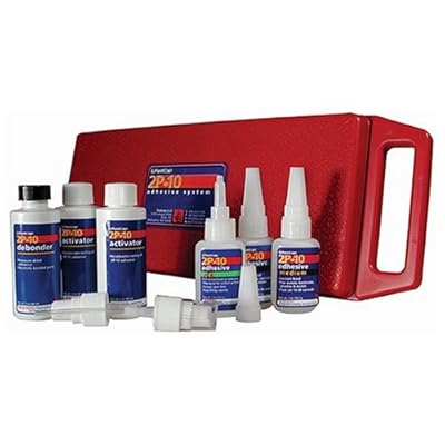

    Or you could always go with my new found love...
    2-P10 Adhesive Kit
