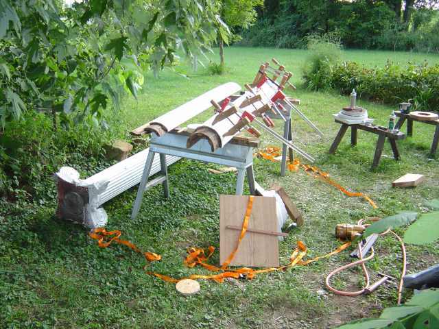

one of our compatriates here at BT, offered me a chance to make some new base’s for some fluted colums..well, nothinf goes as planned of course.
Seems that the plinth was the only thing holding the staves together…
after getting all the glazing putty and caulk outta the joints, the whole she bang came unglued..mee too.
With enough clamps and straps, I just might get em back in one piece.
The new plinths will be the wonderful wood from David Doud…this stuff is incredible…brown ash. looks like chestnut, works like buttah…now if they’d not paint it all…
You need more clamps.
duane...... i like to cut up rubber roofing ( or old truck tire inner tubes ).... strips about 1.5 " wide ... long as you can..
a couple wraps and a tuck and you've got tons of clamping pressure... real cheap too...
did i say " nice work " ?

If you have a surgical supply near you, surgical tubing works real good.
good point.
Duane
If you cant find enough inner tube material you can use the plastic wrap, shrink wrap, I use it on column or round work all the time, works great.
I think you can buy it at the big box stores.
Doug, I got a roll of that!!! I use it to band moulding for transport...DUH. I ferget what it's actually called..but it's on a handle...good thinkin ...thanks
FLAT TWINE!!! that's it..cool stuff
I dont know how man lived before flat twine, must of been like the dark ages!
