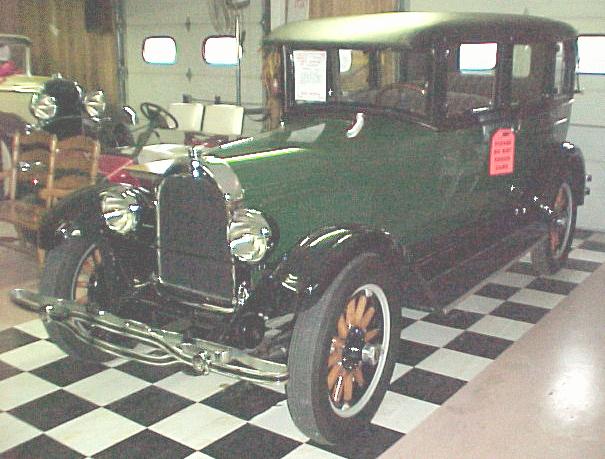

  6. dovetail97128 | May 28, 2009 06:56pm | #14
    Thank You for a memory....
    Your gear making reminds me of a family story
    One of my sisters high school friends scored one of those rare "finds". An old car in the proverbial old widow's garage, car had been sitting since sometime in the 1930's, in pieces. Kid got it for $250.
    He had no clue at all who manufactured it when he picked it up.
    It was a Falcon-Knight, made in Toledo Ohio for about 2 years in 1927/28. Falcon was the coach , Knight made the engine.
    http://clubs.hemmings.com/clubsites/wokr/gallery/fk_hist.htm
    http://www.autogallery.org.ru/k/fa/27falconKnightsedan6cyl3spd_Volocars.jpg
    http://www.autogallery.org.ru/k/f/27falcon-Knight6cylslevevalve_HMN.jpg
    The engine had a thick felt gear to drive the distributor and that was all torn up. He came to my dad for help on the problem and my old man machined a new felt gear for the kid. Gear felt was about as thick as the felt on a piano key is.
    Car was truly a rare car even in those days, Dad had to research the engine at an old car museum in Cleveland to figure out just what was needed.
    I still remember the day that car showed up in our driveway and the kid took my old man out for a spin in his restored ride. Dad looked like the cat that ate the canary, couldn't have been prouder of helping make the old rig run again.
    Got me smiling here at remembering it all.
