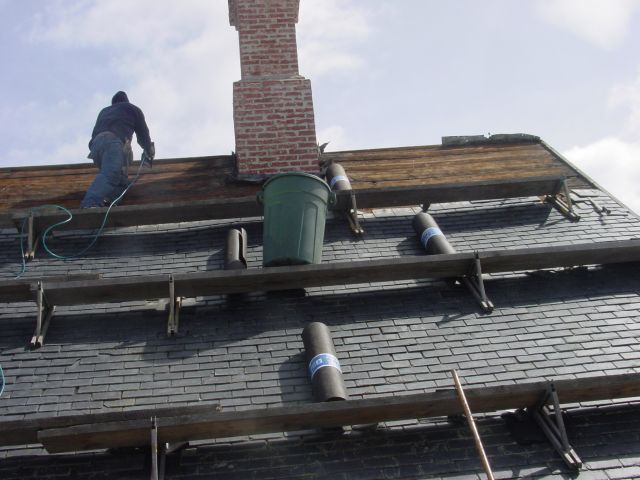

After some medical issues and a tough late Winter I’m back on this project.
We’re stripping off small 7″x 9″ slates ,renailing the sheathing,prepping with 30 lb. felt. We’ll lay 10″x16″ slate from the Gwendolyn quarry in Quebec.
Todays work was removing and prepping some of the roof.

Some more pics of work in progress.
2295 shows drying in over the tops since snow and rain is coming

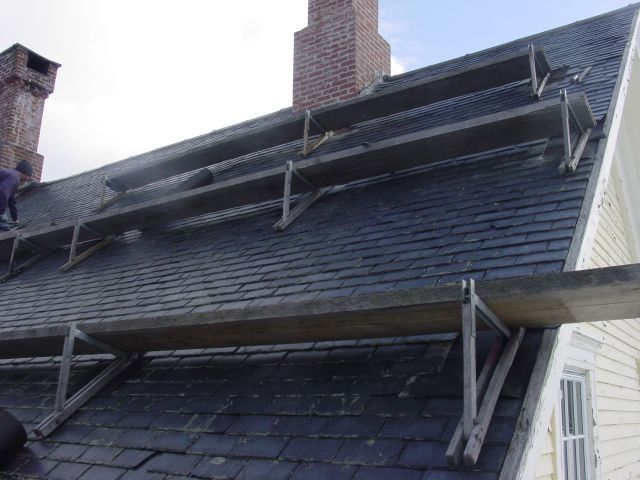

More pictures from work on the front of the main house.
Looking good.
That is quite a bit of staging. Do you have enough to go around a typical house?
Chuck S.live, work, build, ...better with wood
We set piers on this job and used 2 24' pics side by side for walkways, then bolted on our stancions to bolt the alum. backrails to.
Actually this job didn't take as much as some others do. We staged up from a porch roof on the ell and part of the rear of the main house, so not as many frames were needed.
I do own a lot of pipe though so we can do quite a large project with what I have.
Our next large job will be staged by a staging co. for both us and the masons.
Walter
