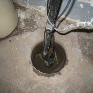

    BTW. Inserting a picture for reference.  That black discharge pipe was also replaced with a new PVC pipe w/check valve that runs out to the street...
    So with that said.. Am I just royally screwed or is there a better way?
    Thanks.

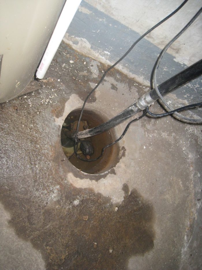

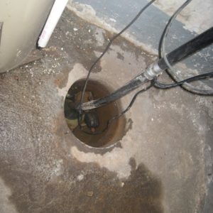

    adding another pic
    Showing the slab seepage..maybe hydraulic cementing the whole floor will do:)
    ...if it was only that simple
