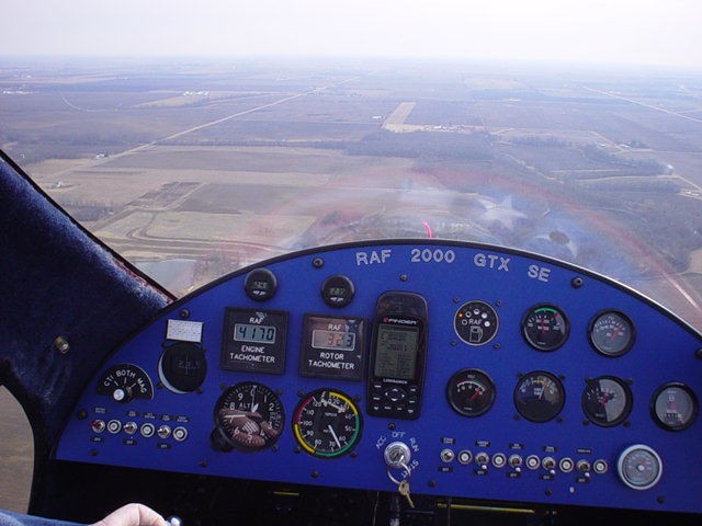

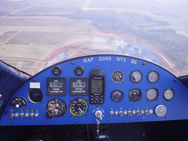

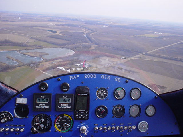

I finally got my RAF2000 inspected yesterday and it was given its FAA airworthiness certificate.
I took it up for its maiden voyage around Paxton, Il today. The winds were over 20 mph ..but that doesnt bother a gyro in the least…if anything…I would rather fly in the wind.
Anyway….here are some rather blah pictures out of the cockpit of Illinois. Any view with altitude isnt blah to me though.
It flew very nice and I am training myself how to fly it..so I am now learning to trim it out for different speeds.

very cool indeed! Nice layout on the instrument panel. I'll bet it's a lot different flying one with a cabin and doors. As I remember your old one was an open cockpit.
I have looked at the idea of purchasing a kit myself from RAF. of all the manufacturerers of Gyros I think that one is the best looking and the most practical. How does the Subaru run and did you hook up a heater being it is water cooled?
Also do you think their timeframe of 300 hours plus or minus a few is realistic for assembly? If I remember correctly yours was partially assembled. Correct?
How does this one compare in terms of area needed to take off? I know it makes a difference with one or two passengers

The Subaru is running perfect. I cant believe how much different it is than the two stroke I had.
The water heater is hooked up...and it is circulating in the cabin..but I do not have to turn the fan on at all. It will easily heat the cabin to 75 even in 10 degree weather.
It was about half built and I had to finish all the controls...wiring..the stabilizer etc. I would say the 300 hours is a good benchmark.
The take off will be shorter with this one. I am going to take awhile getting the hang of bringing the rotors up to speed at the optimum rate. You just dont firewall the throttle..you have to pre-rotate the blades to around 140 rpm..then you start your take off roll and once the blades hit 200 rpm...then you can go to full power. Its off real quick then. As far as landing...this RAF seems to land even easier than my lighter Air Command. It handles like a dream and the rotor seems to have more reserve kinetic energy.
When you land..you bleed off airspeed with backstick..this loads up the rotor and it increases its rpm...then you use this extra lift to make a zero roll or very little roll. They can land in a rockpile if they had to.

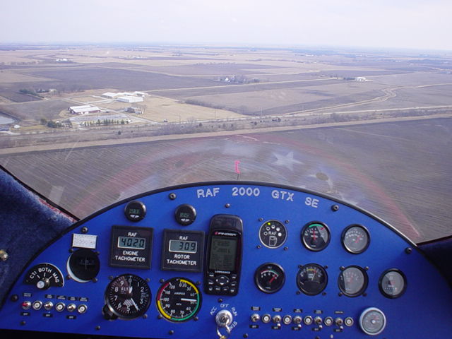

I was up today and took some more pictures.
My home town of Paxton, Il. The last one is the RAF2000 finally on the ground
