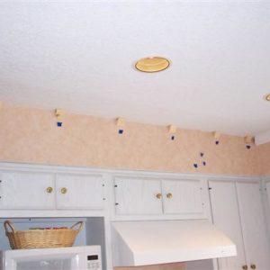

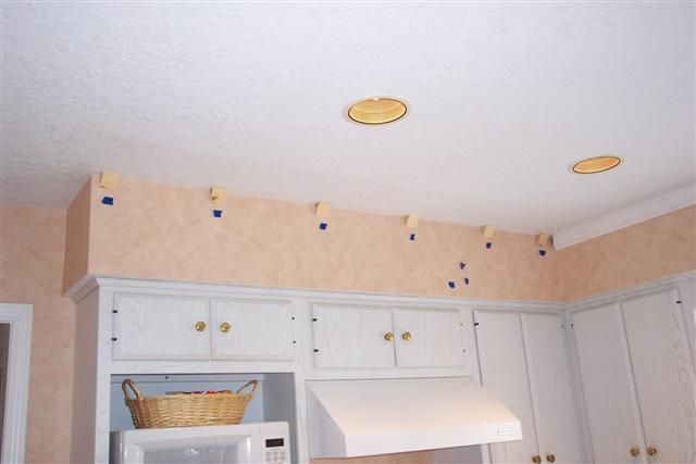

  3. Dave45 | Jul 19, 2005 05:00pm | #3
    I run wood strips along the top of the wall that are nailed into the top plate.  This gives me a solid place to nail my crown wherever I need a nail instead of just at a stud.  The "brackets" in the picture are used to hold the crown in it's approximate position while I nail it off.
