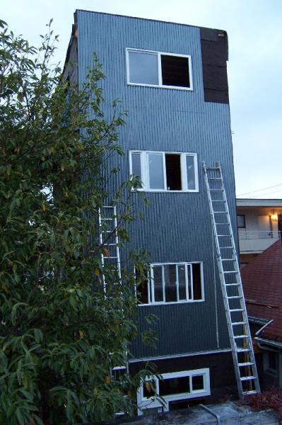

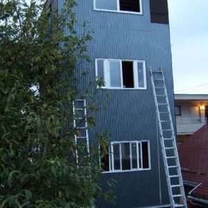

            Hi -- well lemme start by saying that we do have a fully fueled and well maintained chopper on the roof .. so .. if we've got the time to get ourselves to the rooftop we 'should' be ok!
            But aside from this fantasy the codes are pretty strongly enforced around here.  My tower sticks out like a sore thumb and they were pretty hard on me when initially going over the permitt plans.  It has fire-stop external sheathing over the 1/2 inch ply sheathing and then industrial steel siding on top of that.  Even on the side that is towards my house, which did NOT by code require firestop I went ahead and used it.  The only other siding besides the industrial steal siding is fiber-cement siding... also fireproof.  On the inside they required 5/8" drywall all around including ceilings.   Also, the stairs from 2 to 3 and 3 to 4 are on the inside.  And each floor has a deck with a large sliding window AND a door to it.  It is true that from the fourth floor to the large 2nd floor deck is an 18 foot drop, but there are condos just down the street with 30 ft. drops from the to floor to the sidewalk.  Maybe i should also have a knotted rope or something like that on each flr near the deck?  I DO have a good quality fire extinquisher on each floor.
            Lastly, I am literally two blocks from a GREAT firestation.  A couple of years ago a little medical emergency resulted in my calling 911 here and the fire dept. medics were here in less than a MINUTE!  In addition to this they all know about the tower, have come by a couple of times to 'admire' it .. have climbed to the top and stood and oooooh'd and aaaah'd the views.  When they came to the door for the medical situation and I opened it they said, "Hey Tower-guy!  What's goin on!?!?!"
            So ... as long as the chopper is sittin up there idling .. we feel pretty safe.
            A~
            Edited 8/11/2009 5:49 pm ET by newbuilder
          28. newbuilder | Aug 12, 2009 01:09am | #119
            if i did this right there should be a few tower pics attached(?)
