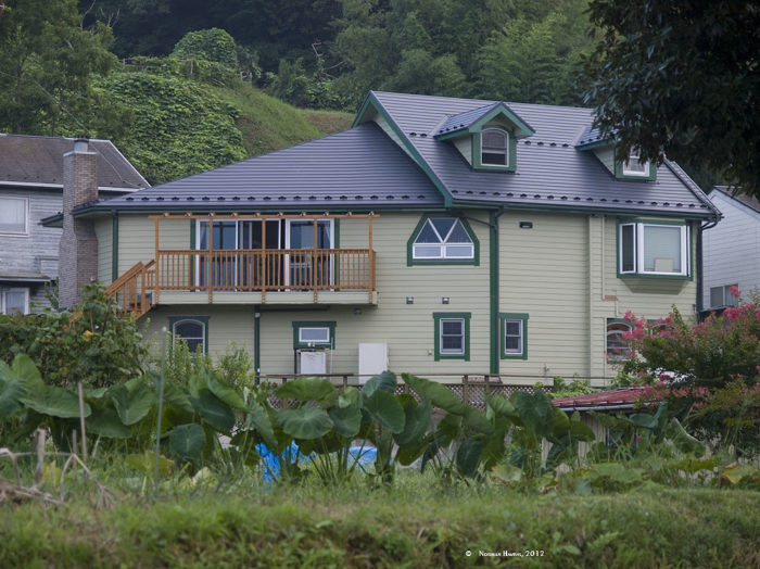

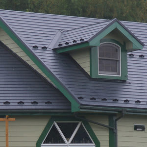

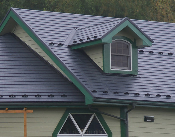

  3. Hokuto | Aug 08, 2012 09:52pm | #3
    My roofer used black flashing; it matches just about anything.
    1. Scott | Aug 09, 2012 02:24am | #4
      That's a VERY nice looking roof. It looks like steel, but with horizontal seams. How does that work?
      1. Hokuto | Aug 09, 2012 06:37am | #5

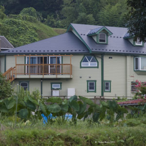

        Thankx, it is steel, with horizontally interlinked seams. I have no statistics, but I gather it's a very popular style here (Japan), with great longevity . Not sure how it is interlinked, but our roofer installed it directly to an existing surface of asphalt shingles. He had a steel forming machine on his truck so he could adjust the strips on site. The photo in my previous message was cropped from a much-larger shot of the entire house. Here's what the whole roof looks like:
