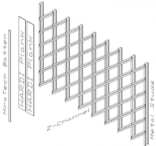

Going to build a “smokehouse” for DW’s kiln (now that the fountain’s in). Just for fun, it will be all non-flammable. 10′ square, vertical board and batten Hardi-plank over metal studs and diagonal (for bracing) Z-channel. No windows; metal door on one face. Pyramidal roof and a little pyramidal-roofed cupola for a heat vent.
But –
How can I attach the Hardi to the Z-channel? On wood I use roofing nails at the edges, covering them with the batten strips held with galv. finishing nails. I think sinking screws would split the edges off.

Well, then either I've got to put the screws in the middle of the boards, where they'd show, or at the edges, where they'd kick up the batten strip. _The diagonal battens will be metal, and are shaped like this _!
How's that for ASCII art?!

I like your illustration. lol. So if I understand correctly the battens will be metal? and how wide will they be? If you can keep the screws about 1/2 to 5/8 from the edge I would think they would hold fine.

Okay - I wound up using the neoprene-washer metal roofing screws - they worked great, and cushioned the clamping, so no splitting near the edges - I experimented with countersunk head screws, and they blew out my skinny battens more often than not.
