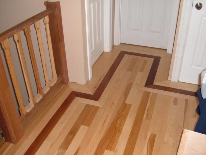

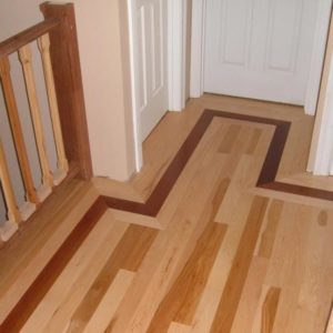

    If you know your layout of your builtins you can still do borders.
    Here is mine
    Floor is Hickory
    Border is Bolivian cherry AKA bullet wood grows in Peurto Rico.
    1. JLazaro317 | Feb 25, 2006 05:11am | #2
      Looks good! I'm somewhat skeptical of doing a border. I don't exactly know what I'm going to do with the built-ins. The house is a work in progress (much like it appears yours is). Also if for some reason I decide to change built-ins or remove cabinets in the future, I'll be stuck with the border in the wrong place. I always try to think of the what-ifs. If it were an entry, hallway, or dining; I wouldn't be having this quandry. The built-in's are throwing me off, so I've almost eliminated the possibility of a border.
      I'm more looking for patern or orientation ideas. I wish that I'd seen yours before the rest of the house went down. I like it!

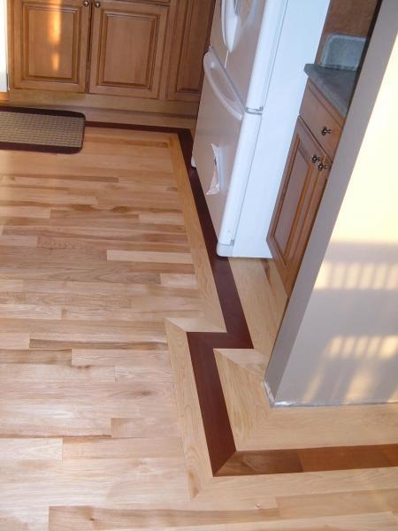

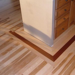

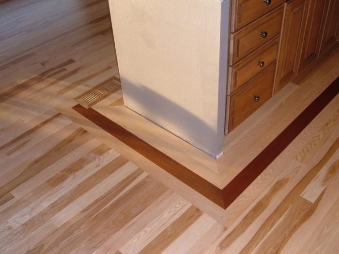

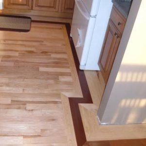

    2. FastEddie | Feb 25, 2006 06:36am | #5
      Nice work plumbill.  But I don't care for the way the floor register interrupts the dark stripe in pic 2.  too bad you couldn't have done something a little differently there.
      Lazaro ... here's a couple of more ideas.  The built-ins should not be too much of a concrn, just stay far enoug off the wall so you could make changes to the cabinets later.  Or, just bite the bullet and jump in with the floor.  Maybe that will take away the future option of changing the cabinets ... one less decision.
      1. plumbbill | Feb 25, 2006 07:08am | #6
        Yeah that register was an oops of sorts.
        Hindsight is what again.
        That register was going to be a toe kick vent when it was an island --- till the DW sat in an aisle way next to the island & said " I want to sit here in the morning with coffee & watch the sun hit the Olympics.
        So the island grew & moved to a peninsula & I forgot to move the duct then I didn't have time to fix it when the floor was going in.
