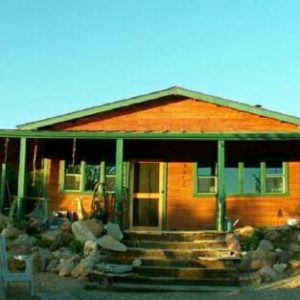

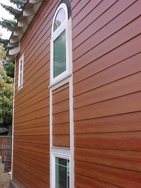

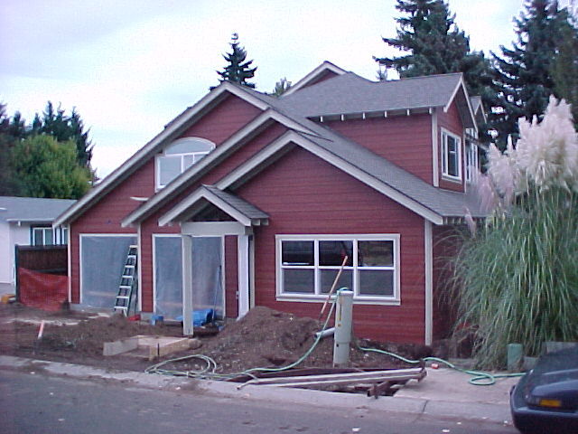

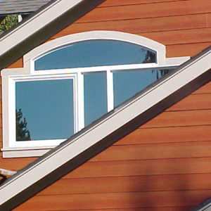

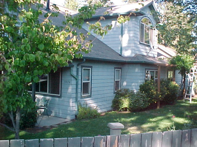

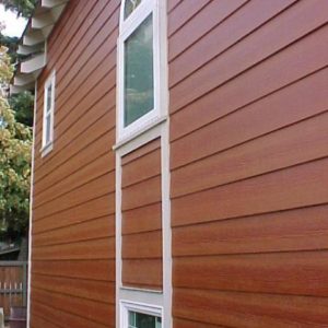

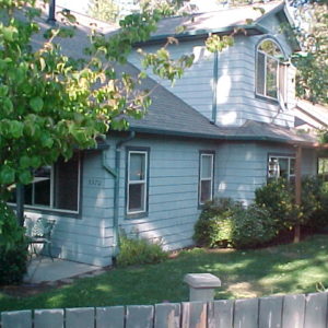

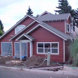

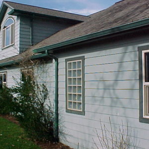

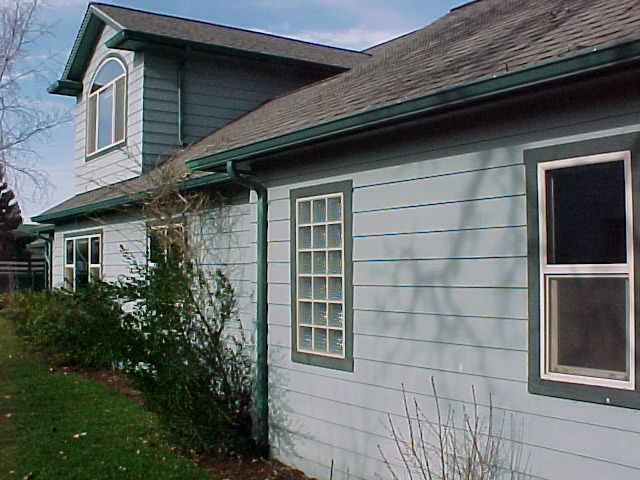

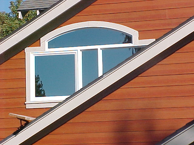

      1. Clewless1 | May 29, 2008 06:41pm | #16
        here are some. One house is the painted style (light green). The other is the stained style (redwood).
        1. Hudson Valley Carpenter | May 29, 2008 06:57pm | #17
          Thanks for posting the photos.
          The redwood stain looks natural in sunlight, right? Can you please explain the apparent color differences between the photos in shade and in sun?  Do they appear that way to the eye?
          I wandered around on the Hardi web site, looking for the stain options.  Didn't find any.  Did I miss them or did you stain the siding yourself?
          What's the outside corner detail on the green house?
          Is that shade of green one of Hardi's available colors?  What do they call it?
          1. Clewless1 | May 29, 2008 08:51pm | #19
            The stain always seems to change color and tone depending on the light. We REALLY like that aspect ... it's never really static.
            The stain isn't offered by Hardi ... it's an aftermarket thing that is done by other companies. Don't recall the brand.
            The outside corner detail is a classic metal corner piece. Don't know the name of the green color or if that is one of the Hardi originals ... we didn't side the green house, just the redwood one.

          3. joeh | May 29, 2008 10:41pm | #20
            The stain is made by duckback  products  http://www.superdeck.com  -- the stain is masons Select Woodperfect.
            I used redwood & mahogany mixed 50/50. I think Jim Blodgett came up with that idea. I did not like either of the 2 colors out of the can, together they are much richer looking.
            HD does not carry it, got mine at ACE. Talked to the factory, they said they did not want to sell through the big boxes.
            Joe H
          4. Hudson Valley Carpenter | May 30, 2008 12:52am | #24
            Joe,  What a great, informative post.
            After checking out the web site's photos I agree that the color you achieved by mixing is much warmer and closer to the real deal.  This makes me more enthusiastic about using Hardi's plank siding on my next house.
            Couple more questions:  How and when did you apply the stain? How many coats? How's it holding up?
          5. joeh | May 30, 2008 01:24am | #25
            I put it on with a weenie roller, laid a bunch out and put on a coat, second coat a couple hours later.
            Think they say wait an hour.
            They also say to spray but I found the variation from the roller made it look much more realistic.
            I have had people who were leaning on the wall ask what kind of wood it was. It looks like the real thing.
            Mixing the colors wasn't my idea, Jim Blodggett came up with that I think.
            It's been a few years and no fading that I've noticed, I'd recommend this stuff to anyone.
            Joe H
