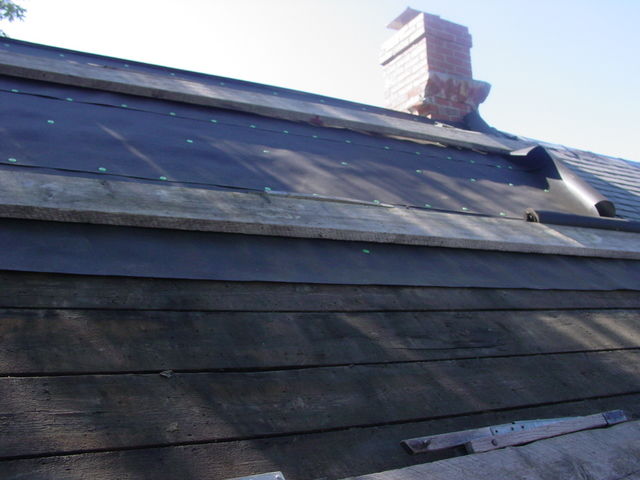

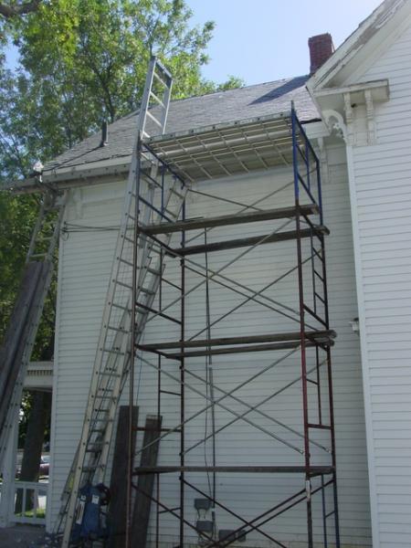

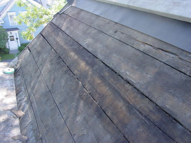

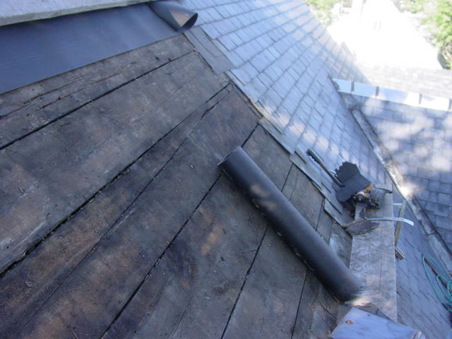

Got called to re shingle this slate roof with architecturals .
The slates will be salvaged for repairs to other homes in my area .
Got my set up done today , I’ll have a helper for the next two days to strip , paper and Grace the old board deck , then lay the new shingles .

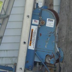

My best man is in the second picture !!

    1. theslateman | Sep 06, 2009 01:05am | #2
      His name is Reiman Georger .  Works hard , never complains , always on time , doesn't eat much or ask for advance money before the weeks out !!
      Sure makes a hard job easy .

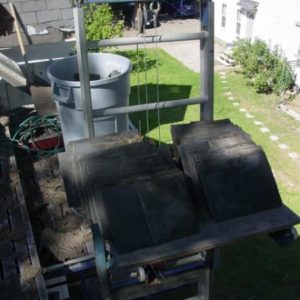

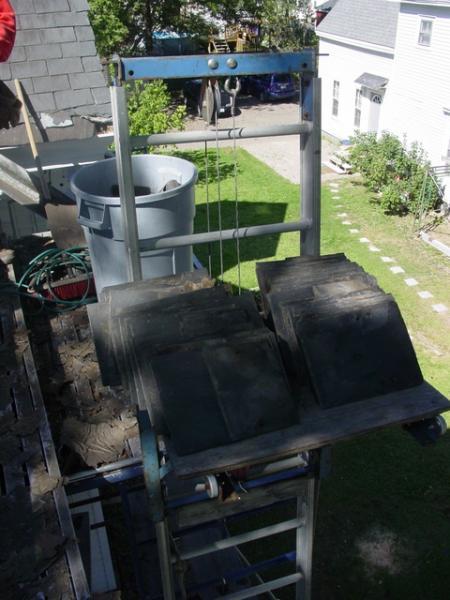

          3. theslateman | Sep 06, 2009 01:27am | #6
            I forgot to add these earlier .

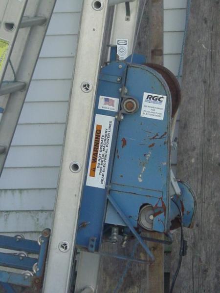

            The third picture illustrates how I make my ladders more of a challenge to climb / and /or steal when left overnite .
          4. Piffin | Sep 06, 2009 03:36pm | #10
            A ladder with a jack and plank on it is pretty tricky to walk off with easy! LOLis this in Belfast again?
          5. theslateman | Sep 06, 2009 11:56pm | #12
            Paul ,
            Fern St . in Bangor . More concerned with making climbing the ladders a little tougher . I do lock up the hoist motor to the base ladder to keep people honest .
            I think Hazlett takes his down every nite -- something I'm unwilling to consider on most jobs .
            Walter

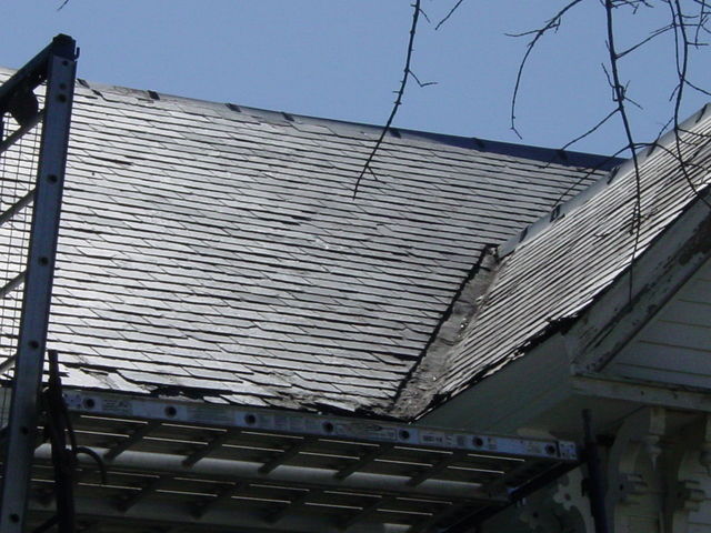

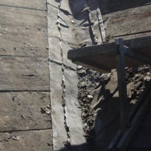

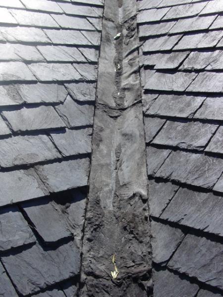

      1. theslateman | Sep 07, 2009 12:22am | #14

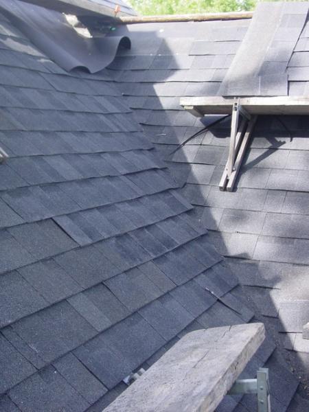

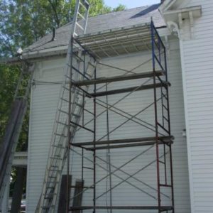

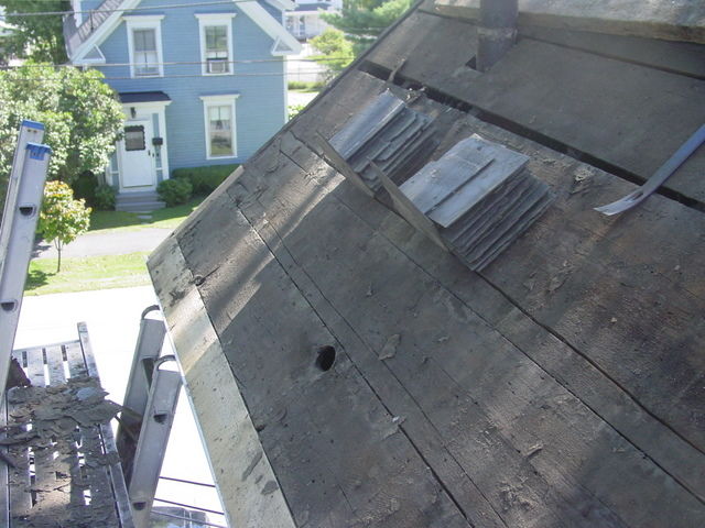

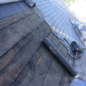

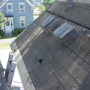

        Some pictures of todays work of stripping off the slate , lowering and loading it up , then reshingling the prepped deck .

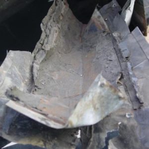

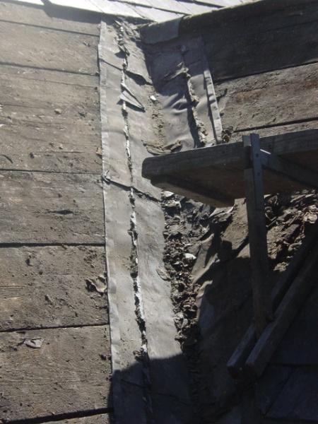

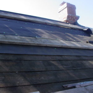

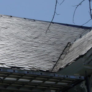

        1. theslateman | Sep 07, 2009 12:25am | #15
          A few more from todays efforts .

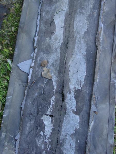

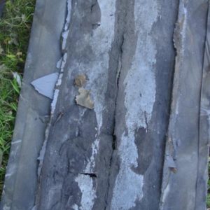

          1. Piffin | Sep 07, 2009 12:51am | #16

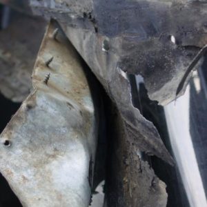

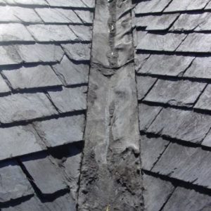

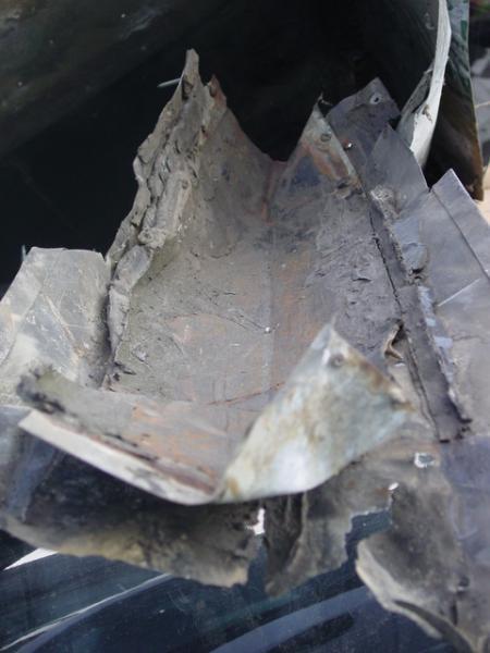

            Don't get to see a valley that worn very often.
          2. theslateman | Sep 07, 2009 12:58am | #17
            Zinc and aluminum are poor choices for valley metal . This house just changed hands  -- a 4 unit building , so preserving the slate wasn't deemed necessary here .
            I'll be repairing and flashing the chimney on the South side though . Straight pitch without any valleys there .

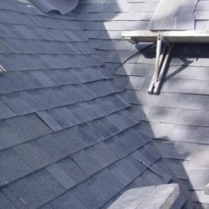

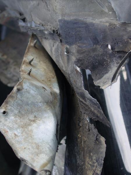

          3. theslateman | Sep 09, 2009 01:45am | #24
            When the zinc valleys wore thru on the backside of the dormer they took some galv . and screwed it in place  -- without removing the slate or zinc .
            A little black magic on the sides and voila -- end of leakage !!!

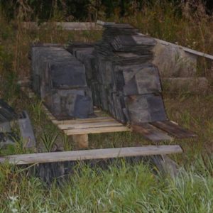

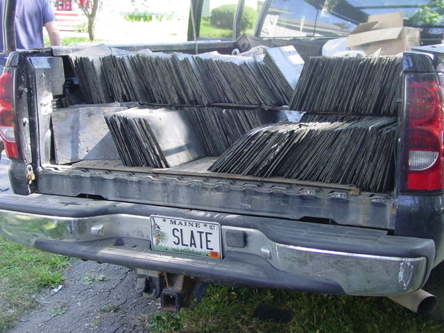

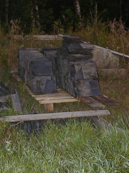

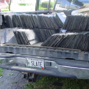

          9. theslateman | Sep 10, 2009 02:15am | #30
            Heres the results of the harvest !!
          10. User avater
            Sphere | Sep 10, 2009 02:30am | #31
            Better cover them, I'd hate to see them get wet.Spheramid Enterprises Architectural Woodworks
          11. theslateman | Sep 10, 2009 12:06pm | #34
            Why  -- I'm speechless !
          12. mikeroop | Sep 10, 2009 06:04am | #32
            I have about that many new ones on a skid whats it worth?
          13. theslateman | Sep 10, 2009 12:09pm | #35
            Mike ,
            Depends on size and where quarried !  And most importantly what someone is willing to pay , since it won't be enough to slate a very large roof , but will need to be matched or used for repairs .
            Walter
          14. mikeroop | Sep 11, 2009 04:14am | #38
            are you taking up politics? ( with that answer) :)~
          15. theslateman | Sep 11, 2009 12:07pm | #39
            Mike ,
            Not at all . Different quarries produce varying grades of stone for roofing .
            If it comes from a good quarry and of a larger size  -- 10" wide or up then it has more value than some 7" wide slate from Penn .
            If you stated the sizes and where it was from I would be more helpful .
            Walter
          16. mikeroop | Sep 12, 2009 12:49am | #42
            they are all 10" wide and I believe they said they were from vermont.
            left over from a big job and the roofing supply store took them back and gave them to me a couple years later along with a bunch of misc. stuff I bought really cheap. :)
            not trying to pin you down but I've no use for them (Thought i did at the time) and have been thinking of trying to unload them.
          17. theslateman | Sep 12, 2009 12:58am | #43
            Put them on Craigs list for $ 350 a sq . and see if you get any interest .
          18. USAnigel | Sep 10, 2009 06:47am | #33
            You did good! Last slate removal I did blew away in little dust clouds it was so past its prime! I had patched it the year before and used screws to install because the slightest hammer blow dislodged a few more slates!
          19. theslateman | Sep 10, 2009 12:10pm | #36
            It must have been Penn . slate which is quite soft .
          20. USAnigel | Sep 10, 2009 01:51pm | #37
            I think it was, Roof was from the 1920s in Philadelphia. i took very little to the dump from a large roof. I saved the pieces I screwed on.
