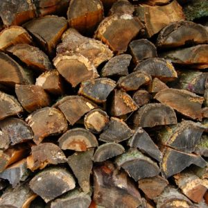

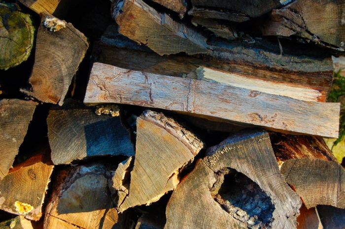

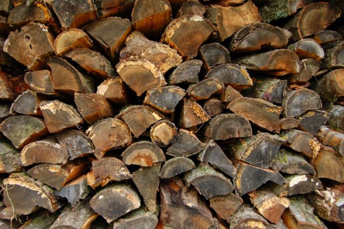

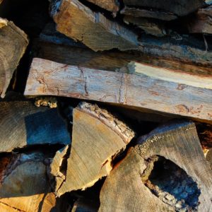

            johnnyd | Nov 01, 2006 06:26pm | #15
            Some of the prettier results of splitting and stacking
          3. Piffin | Nov 01, 2006 11:24pm | #17
            Dang, Johnny, Your sapwood is growing more mold than mine! Another good reason for keeping the wood outsdie untill time to burn, those spores are not healthy to have floating around the house

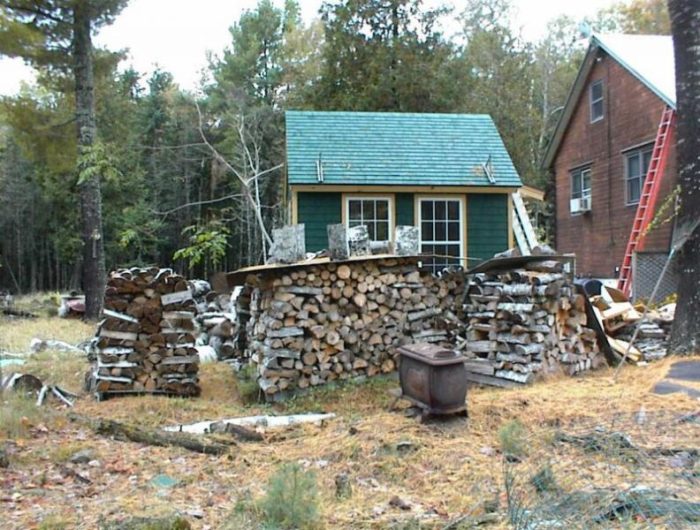

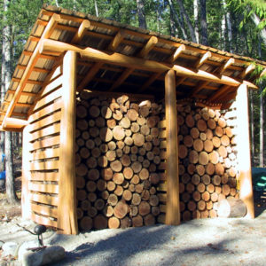

          1. Ruth | Nov 01, 2006 11:32pm | #18
            Another woodsplitter here, anywhere from 3-6 cords per year of green wood I buy cut to length. I use a 6- or 8-lb. maul and a wedge when necessary. It's a good late winter project. I like to work no more than 2 hrs at a time, usually less, and often before work. Can't say I've done any chainsawing, but I do wield a mean bowsaw on smaller stuff.
          2. BoJangles | Nov 02, 2006 02:49am | #30
            WOW!  That's a beautiful woodshed.   I was thinking of making one this fall, but now that I see yours, I may change my plans a little!
          3. Scott | Nov 02, 2006 04:43am | #41
            Well, if you're going to go to the work here's a couple of tips...
            - don't use log rafters unless you have really straight, uniform trees; or unless you like spending a few hours crawling around with a power plane.
            - use rough sawn 2X for the side slats. I made the mistake of using nominal 1X and they bow outward like crazy. Besides, the rough sawn would look more in character.
            BTW, the slatted design works very well. It holds the wood but lets lots of air through to dry the wood.
            Good luck,
            Scott.Always remember those first immortal words that Adam said to Eve, “You’d better stand back, I don’t know how big this thing’s going to get.”

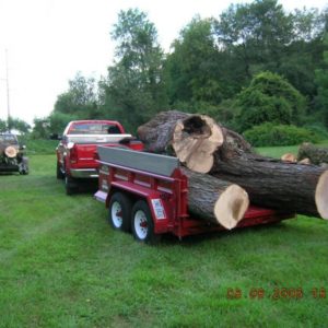

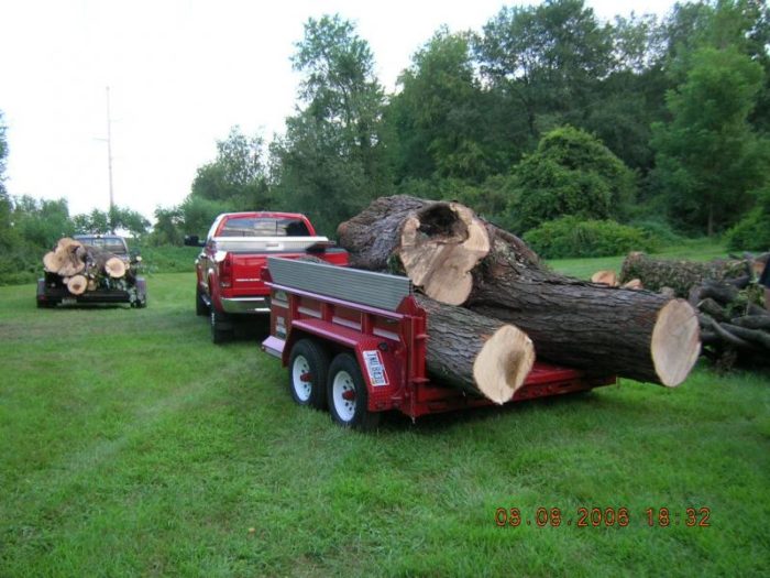

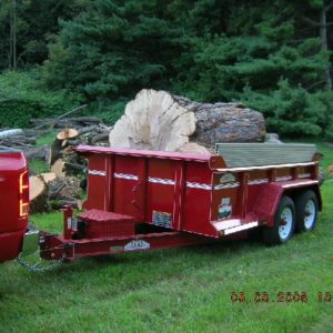

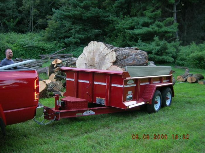

        3. BKCBUILDER | Nov 02, 2006 12:04am | #20
           Hand splitting....uh, I'll pass....roto cuffs are both in bad shape. Plus, you guys are splitting a different breed than I.
          1. BoJangles | Nov 02, 2006 02:51am | #31
            That is a beautiful dump trailer.  What brand is that.  I can't quite read the label.
          2. BKCBUILDER | Nov 02, 2006 03:01am | #32
            Moritz...Mansfield, Ohio...That log was #8000  lifted it with no problem. Empty weight is #3400 so it's a little on the heavy side...but worth every penny...5K.
          3. BoJangles | Nov 02, 2006 03:10am | #34
            I am going to get a dump trailer soon.  Does Moritz sell them direct or did you buy it from a local dealer?
            Any suggestions as to what to look for in options, size, whatever.  If you own one, you know a lot more about them than I do and I want to get this right the first time!
          4. BKCBUILDER | Nov 02, 2006 04:02am | #40
            Biggest things I looked for the second time around was scissor lift, torsion axles, two way gate(barn doors and metering gate) battery that charges off the truck when hooked up and the thickest steel I could find. It came down to Moritz and Corn Pro.... Corn Pro was another $1300 for only 200#more weight....so I went Moritz. I bought thru a dealer, not sure if they sell direct, but the factory is only 50 miles away, so if I ever have any issues, I know where to go.

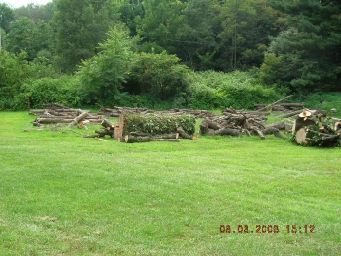

        2. rez | Nov 02, 2006 02:18am | #25
          If yer not going to be splitting wood like BKGBuilder Roar!View Image
          then I can say it might be worthwhile looking into a more economical smaller 'Yardmaster' splitter.
          I've been using one of late not had a problem as most woods are in a standard 18" to 20" length.
          Goes thru some pretty gnarly knotted oak trouble free.
