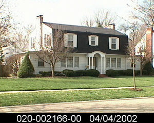

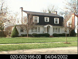

Good morning all,
I am enclosing a photo of my dutch colonial. It has a gambrel roof–so I’m told, that we would like to change. We just aren’t sure what we need to change. Prior to moving in, the previous owners added a white strip across the top of the front I guess to help break up all that black.
What we don’t like is the starkness of the black and white. The roof currently just has plain old black shingles. Any suggestions on what could change the look drastically? Would just grey dimensional shingles help? I’ve seen some of the discussions on cedar, is that product tremondously different price wise? You can’t really see it in the photo too well, but this roof is just ugly–the shingles are big, flat and boring. This is the city auditors photo, I should post one of mine with closeups so you can see the details.
We plan to put an addition on the back of this home someday and depending on what we can and can’t do–both financially and zoning wise, we would probably incorporate the roof cost with the addition. Does anyone have any good photos for inspiration or any other ideas?
Thanks.

    How about a prefinished western red cedar shingle roof with a copper flashing at the break?

    Cedar, at least to me is the way to go on your house.
    Red cedar is right and be sure its still green when you get it so its not so brittle.
    All the cedar roofs I see look so breath taking IMHO and your house is half roof so.....
    For my house I'm going to re-cedar the existing roof and to the additions I'm doing now.
    Thought about a green on the trim to match the copper gutters that will turn a sort of green.
    My house is red and shall remain that way.
    I hate (I mean dislike) blandness.

      Thanks for the reply. You think just  tear off the old roof and replace with cedar, leave everything else as is? I do like that idea, will have to investigate costing.  Wasn't it your website I saw a before and after w/dramatic difference? Very pretty. I also like the copper flashing idea from Cedar. There are many dutch colonials in my area with that bump out or whatever you call it on the second level--with the set of windows bumped out. In fact, I haven't found a dutch colonial in my neighborhood with the same roof line as mine. Do you think this is the original roof line??
      Isn't there "faux" cedar? Is this worth investigating?

        Your roof would be easy to rip because you could do it easly in sections being that theres a dramitic difference from the top to bottom sections.
        Yeh, that was probably my website you saw(http://WWW.CLIFFORDRENOVATIONS.COM). Not sure why it's not there anymore but I haven't revised it in a long time (too busy) and onto much more interesting projects.
        Ripping the entire roof? You wouldn't have to. You could go over it if you created airspace between the roofs but I'd highly recommend removing  the existing ....just because thats me, not because you'd "have to".
        Different strokes for different folks.
        My guess is that it'd be certainly easy to rip the lower sections off b4ing that they're only walls really.
        How many roofs have been put up there?
        Nahhhhhhh.rip it and do it right.
        Isnt all that difficult and from the looks of your property you should be able to place dumpsters directly below with ease.

            Guess what, had a roofer come out for an estimate to replace the roof. Guess what's under my bland shingles? Cedar! He quoted me about 12 grand to tear off shingles, cedar, whatever the stuff you install the cedar on, resheet, and reroof with dimensional shingles. Also some minor flashing repairs.
            Can you believe they put these ugly shingles over cedar. I had an architect come out too for ideas. He's going to work me up something just to help it aesthetically for now--maybe some kind of moulding (?) details, window boxes etc. We want to put an addition on someday so he is going to give us some inexpensive ideas we can use now that could stay with the addition. For $12k, that roof is staying till we do the addition, ugly or not!

            It's pretty common to overlay cedar shingles with asphalt. I once ran into a cedar roof with 6 layers of asphalt on top. I wondered why the shingle molds were 1x6 instead of the normal 1x2. They were covering up the thickness of all the shingle layers. If your roof is not currently leaking and you're considering adding an addition, by all means, wait until doing the addition to reroof the existing. If you're using asphalt, its hard to get a good match several years down the road. More than likely, the cedar is installed over split sheathing, so you may be able to avoid the cost of resheathing if you reroof with cedar. Make sure you get good references before hiring a roofer to install cedar shingles. There's lots of good asphalt roofers out there that don't have any business installing cedar and vice versa.
