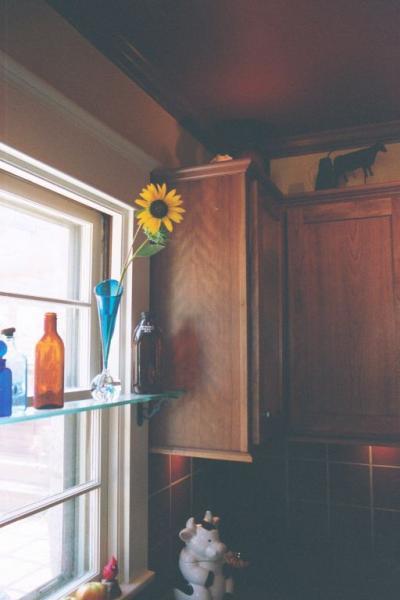

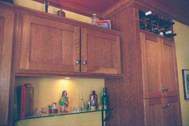

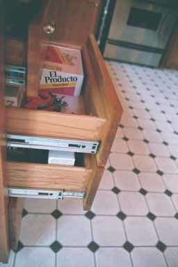

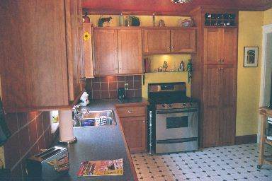

Thought I’d show some photos of a completed Cherry kitchen. My client called me back after she painted and decorated for a photo shoot. Came out ok. Ya, my design and labors.

Yes I must say the color scheme surprised me. The client is a professional painter that has helped me a lot. When I agreed to build her cabinets she said to let her do all the finishing.
That was ok because I would have called her up and offered her the job anyway.
But I must say the red cielings and mustard walls with the dark red tiles looked fantastic.

I like the colors on the wall. The only thing I didn't think worked as well is the red tile with the black and white floor....seemed like they were from different kitchens. The rest was all real purrrrrty.
I agree with Cloud, the floor is just not consistent with the cabinets and paint and the tiles. But I'm seeing a lot more of this particular color scheme, and while it's not "me," I do like it. It's very warm and inviting. Very spicy, and the cherry isn't overwhelmed.

Excellent! How do they like the sink faucet?
They haven't complained!
If I remember correctly it is a genuine imitation pewter one (plastic).Mr T

Nice cabinets but how is that ceiling done?
Tell me about that ceiling.Never be afraid to try something new. Remember, amateurs built the ark, Professionals built the Titanic.
Ceiling was existing we just had the dry waller patch some spots that needed it.
just a textured mud job, looks like it was done with a round brush.
Roll wet mud on with a thick nap roller and daub it into a pattern with the brush.Mr T

Is that a granite counter?
Sort of makes my kitchen look absolutely shabby......
Island is granite, rest is corian,Mr T

That black and white floor is what I like to call a "Cleveland Heights floor"......We have that type of floor in our bathroom and many older homes here(hah, they're all old!) have that floor.....

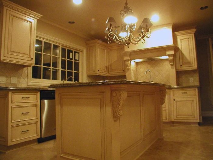

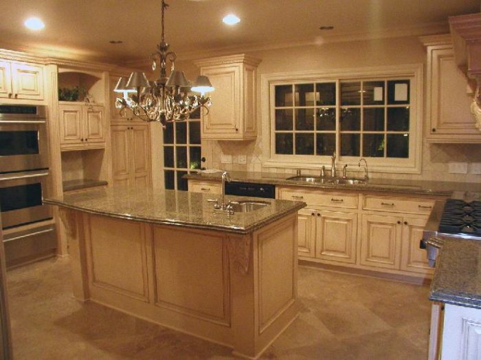

here is a real fun one I did about a year ago...
greg
Hey GB, that's no fair! I'd be embaraased to follow that - couldn't out brag that one..
sorry, Piffin... guess I got carried away...
(thanks, tho!)
Nonsense, Great pic's
"Some of us are really good, and the rest of us
are better" ha

Bob,
You built the cabinets?
What stain did you use? I love cherry and your color is right in line with my tastes.
Secondly, it looks like your upper cabinets do not have the typical recess (space caused by the faceframe rail and a bottom which is flush with the top of the rail). Is this correct? Nice furniture look.
What under-cabinet lighting did you use?
Yes I built the cabinets myself. This was a job I did for my painter, she did the finish herself. I'll try to get a hold of her and ask, post later. Probably a Benjamin Moore product though.
As to the construction, cherry faceframes with a cherry crown on top . On the bottom is an applied molding I made to allow for a deeper recess for the 3" puck lights. Doors all use a 110 degree cup hinge. Drawers are all dovetail assembly with full extension glides.

Did you mill your crown molding? Cherry moldings are hard to find stock or special order.
There's a great molding company here in Tulsa. Even though their cherry millwork is normally limited, I caught them when they were doing a special run for another client. Talked them into 50 foot of crown. Otherwise I was going to create some myself. I'm lazy in some ways, this was one of them. A choice of $120.00 or so, verses $40.00 material and about 2 hours labor, no brainer.
