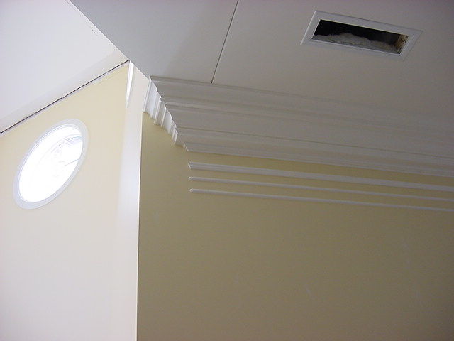

But they did have some very nice crown mold. I liked the way they built it up.Very classy. If I ever buy a house with a room sizable enough to support the look It’d be the first thing I’d do to it. I really liked the layering. BUt they had no symmetrics when they ended at a return.

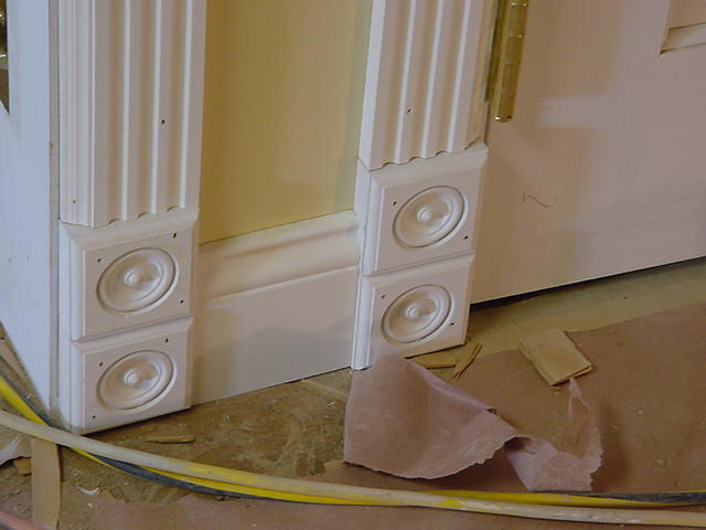

I snapped some pics for you. The double rosets at bottom of the door still have me scratching my head.

I'm with you on those rosettes. Maybe somebody had the plans upside down and they belong on the top!

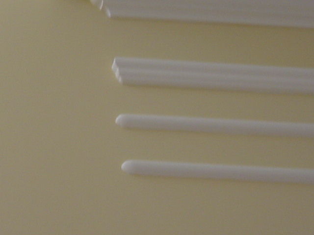

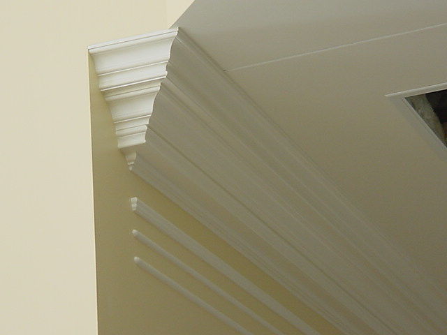

The crown returns look much better, but that's an unusual design too - three parts, all separated? Betcha the next painter's going to love that.
Don
I'm not so sure about the moulding applied under the crown, I don't like.
and someone should tell those guys they probably sell plinth blocks where ever they bought those rossettes.... probably cheaper too...
I like the crown detail, pretty cool and nice work but the use of the rossets, I'm not to sure about that.
What CAG said, should have got plinths.

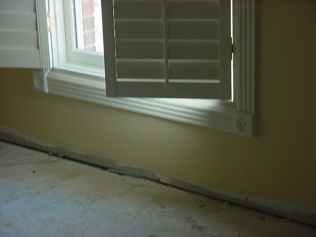

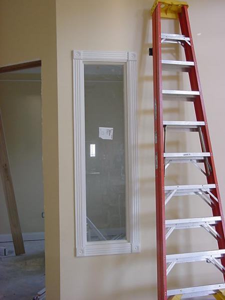

Do any of you feel the rosettes are too small for the casing? Looks like they went to a parts box and stuck them together.
Incidentally, the second shot reminds me alot of Monticello.

that's the same crown ... just again ... and again ... maybe again?
and I agree ... the rosettes are the wrong size ... they shoulda upsized them at least 1/4 ... may 1/2.
And those doubled rosettes ... uh ... Plinth blocks were created for a reason.
But ... the crown .. aside from the star track lazer effects ... looks cool.
I may even steal that idea.
I've stacked tons of "off the shelf" trim before ... but don't think I've ever stacked the same crown on top of the exact same crown.
I like it!

looks like they had 4 layers of crown and when they sheet rocked and skimmed in the walls it buried most of the bottom 2 layers.
the strip details need to be stepped back at the spring angle of the crown to look right.

Obviously nobody has a rosette cutter.
Those things are easily made to fit the application, all you need is a drill press & a router.

The Laser beam crown-the low land Rossettes, the rossettes with no stool/apron, this design had to come from somewhere else--I'm not sure I could do this and not have bad dreams.
On the plus side I do like the mitred returns-I wonder if they ran out of rossettes using them as plinths--
If you can make them double tall for base why not double deep for crown?

I was gonna say what MisterT said--looks like nice old crown with the frieze board burried under sheetrock.
Last weekend at a friend's house I saw the double-crown idea, actually it was pretty similar to the one you posted. At first I thought it looked nice, then noticed the repeating profile and said to myself "that's not right." But it still looks nice, and no one else is going to notice that the profile repeats, or at least they won't care.
Stacked rosettes as plinths? Ugh. For rosettes to look good, I think the casing needs to be wider, as well as the rosettes.
That crown looks like plate rail. Don't know that I like how they terminated it (would have looked fine as a plate rail termination though)... and those little strips below are going to be a bitch to paint later.
I actually like non-mitered trim. It is easier to do and is less likely to look crappy later. These folks just needed to add plinth blocks instead of doubling up the rosettes.

I think that crown would look better if they minimized the returns to the walls out in the open and then painted the same color on the crown and the little sections of wall in-between. Thereby giving the illusion of one really large piece of crown.
I've seen that "Ceiling - Crown - Wall - Small Detail Piece - Wall" layout before with only one "small detail piece" and the in-between space painted white like the crown on a colored wall. Looked good, except where it ended on a wall and not in a corner.
Yeah, I thought that might be neat too. But they'd need different trim along the bottom. And probably 9' or better ceiling height to carry it off.jt8

Those double rosettes remind me of a kids boom box, just need some dials in the middle. Hopefully the trim carpenters were scratching their heads when they put that in.
I think they were all around carpenters. They were union, and they worked for the GC so I'm pretty sure they've been there from the start.
One thing that is really sad is they didn't have anything to do with the design. Some designer somewhere thinks double rosetes are acceptable.+

Since it's not "your job" I can criticize... When I opened the first pic and saw the built up crown, I thought, "interesting"... Then I scrolled down and saw the triple picture rail effect... Looks like a good example of someone who has the money but not taste... They probably saved money on the arch/designer though- So and so's sister in law is great at picking out fabrics so let's have her design the interior!!
