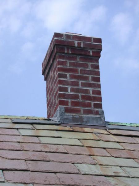

met with the owner Saturday.... got some more pics
the chimney we tore down to the attic & rebuilt last year
here are some good ones of the front hip....you can see some of the new slates Barry installed over the years.... and the mesh & red fibered patch
all the grey slates are replacements from Barry
notice the minimal roof edge overhang... we think this may be contributing to some of the leaking .... whadda ya think ?

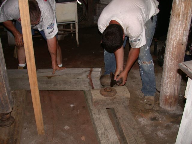

in the meantime....... cracks in some of the walls ....indicated some settling
investigating with our laser showed us that some of the point loads had naot been adequately carried when it was built back in 1905
here's one of our screw jacks I inherited from Tom Priest back in about '75.... Tom was the pre-eminent building mover in Southern RI back in the '40's thru the '60's.....
we have about 5 of these...
they insert into jack boxes made from 2x6 nailed up round-robin....
ramming it home with a 4x4 club
we can scab them together to make taller boxes.... or cut them down , as in this case , for low ceiling work
we're going to set two jacks , one on each side of the point load stress we want to pick up with a new lally column
Mike Hussein Smith Rhode Island : Design / Build / Repair / Restore

Mike,
The slates look to me to be mostly in place and mostly whole.
Nice larger slates so there is more sidelap than on narrower slates.
The lack of overhang draining down the old cedars might be a source as you suggested.
First thing I'd do is put new open 20 oz. copper valleys in place - tapering the exposure from 6.5" to 8" at the bottom.
I'd also reflash the chimney into the roof with copper to help there and get rid of the rust potential.
