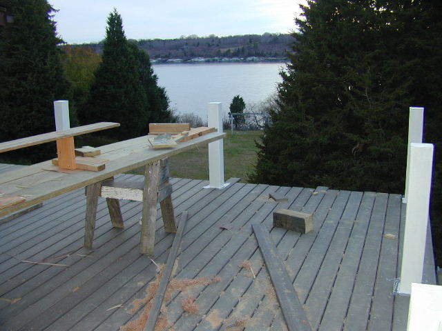

        G80104 | Jul 06, 2003 03:13am | #11
            Mike,
                     I can say it, " What a Beautiful Deck "  The  view is pretty killer also!

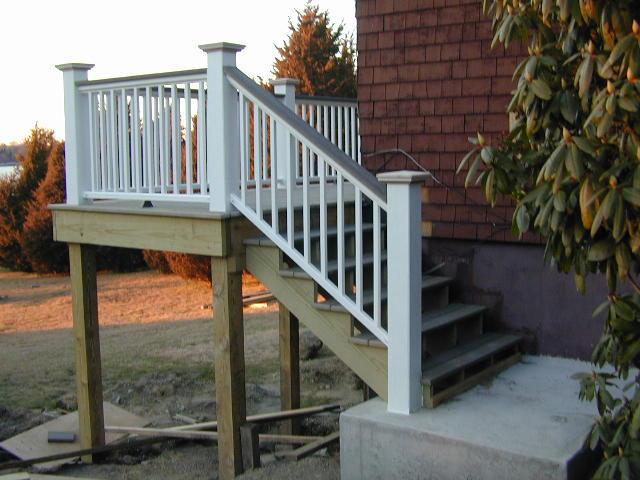

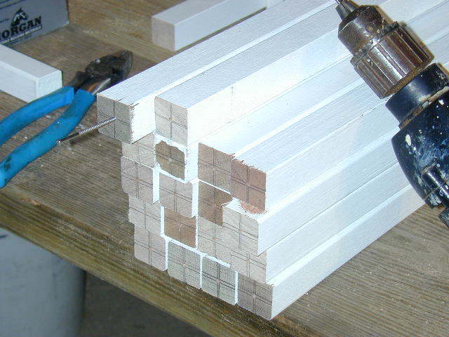

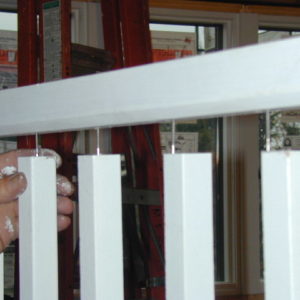

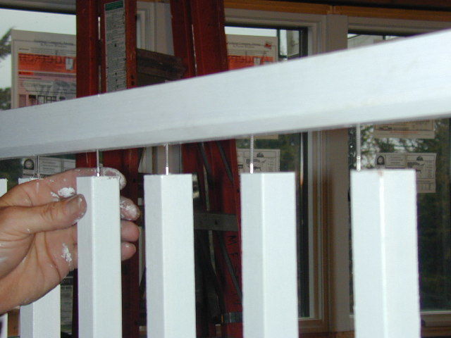

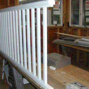

        Mike

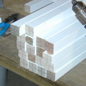

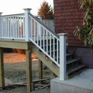

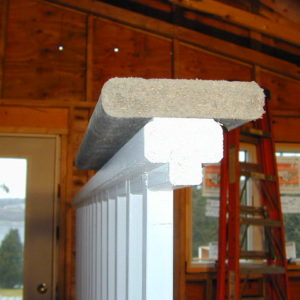

         I liked the photo's! Not to get off the subject, but what did you use for the railings? Is it a composite, with a wood top rail or are those cedar posts??? Just curious, I'm gonna go with the Trex for decking, but there railing systems are too much ,money, and honestly, don't really look that good anyway. I don't understand! I cut it twice and it's still too short!
        1. xMikeSmith | Jul 07, 2003 02:44am | #16
          the sub rail was ripped from 2x6 red cedar..  the shoe was from 2x4 meranti, the balusters were from 5/4 x 6 meranti... and the cap was trexMike Smith   Rhode Island : Design / Build / Repair / Restore
          1. KGambit | Jul 07, 2003 03:51pm | #17
