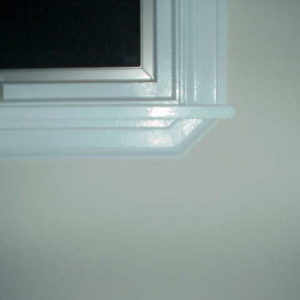

        G80104 | Sep 13, 2005 05:24am | #15
          Is this the type of return you are looking for?
        1. Shep | Sep 13, 2005 05:28am | #16
          Nice detail. I gotta remember that one.
        2. Piffin | Sep 13, 2005 05:34am | #17
          Gotta confess, I've never seen that one before
            G80104 | Sep 13, 2005 06:00am | #18
              Simple but a little class! Used to work for a guy that had a thing about End grain!

        3. johnnysawzall | Sep 13, 2005 06:17am | #19
          Not exactly what I was looking for (I'm using 2 1/2" col. casing) but definitly neat looking!! I like that alot, what type of trim is the apron?

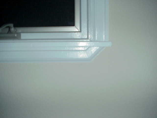

            G80104 | Sep 13, 2005 06:28am | #22
             Window trim is 2 1/4" Anderson trim, (the name used around here) same stuff that is used to case doors. Cut @ a 22 1/2 times 2. Very simple to do, EZ on the fingers also!
              The apron is popular ripped & painted, use long trim screw to attached to Pella Pro line windows. Fill holes with bondo. Also round over edge of apron with router & round over bit.
          3. johnnysawzall | Sep 13, 2005 06:44am | #23
            Very nice. We're doing all stain grade work this job wish I had some pictures to share but I just can't remember to bring the camara to work. I make all my sills myself (either 3/4 pine or 5/4 pine ) with a roman 0gee router bit. Route it face up then flip it over for a sill. I then fit all my aprons just shy of the last revel underneath. They should line up with the casing above the sill. Its a pretty look but I was never satisfied with the end grain on the apron. I'm gonna try the suggestions here but for some reason (and I may be over complicating things here) but I think you need a compound miter. I'll find out tommorrow.

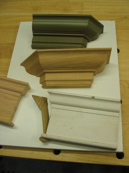

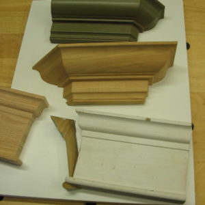

    It's about time Johnnysawzall! I've always thought it was low end not to miter a return on moldings, either you're a trim carpenter or your not.
    A 90° miter on the end is fine but you can also get a different look by using combinations of 90°. Cutting and keeping control of the small returns is pretty easy. Take a bunch of short waste pieces and cut your 45's or whatever angle on them, a left and a right on each end. Obviously you want the scraps to be long enough to safely hold on the saw, 4"+. It helps to add a sacrificial wood fence to the miter saw with a couple short screws through the holes. After the miters are cut, I'll cut 30 or more at one time, you just turn the piece upside down, set the saw back to 90°, and cut even with the short point of the miter. To keep the small piece from blowing away, anchor it with a piece of masking tape. Leave the saw blade down until it comes to a stop. To use a miter saw safely, you should do this with every cut, every time, few do. When you make the cut, you will want it right on that short point, that way the return won't be too thick and stick out thicker than the back of the molding.
    To glue the pieces on, I use Devcon Weldit all purpose adhesive, there are other brands that are basically the same. If you use a water base glue, the small pieces will often curl and warp. I put a liberal amount of the adhesive on one piece and squeeze it to the apron or whatever I'm returning. It grabs and dries very fast. You can use some masking tape to pull things together when you need to. Any squeeze out can be cleaned up easily after the glue is dry with a sharp utility knife and a bit of fingernail. Once you've done a few, you'll know just how much glue it takes and you won't have much to clean up.
    I have a picture of a few types of mitered returns that I use to explain the look to customers. They usually don't know what a mitered return is. I actually had a customer that wanted to know why I didn't just cut the moldings square, after I had installed some chair rails that had to stop at some uncased openings. I thought to myself, any hack can do that, but I figured I'd better have some samples to explain the cuts for future jobs, just in case.
    1. Piffin | Sep 13, 2005 04:54am | #14
      Good shot, there.
