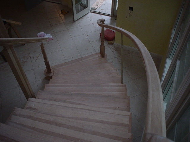

This is a little hickory stairway that I have been installing. It is freestanding and has a plastered belly underneath.  I have hickory spindles to install along with all the balcony railing.
Excuse the mess I inherited when I took these pictures.
Stan……who is on the ground climbing.

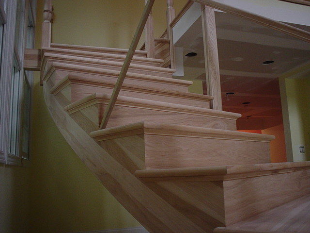

    The scotia(sp?) mould under the treads would be difficult for me to get right(tight
    joint) as those aren't 45 degree cuts are they?  How do you figure them or do you
    use something like a bosch angle finder?
    1. StanFoster | Jun 17, 2004 01:02am | #2
      Butch:   The risers on this stairway are all perpendicular to inside and outside stringers...making the miter a typical 45 degree cut.
      However...the trick is cutting the curved scotia at its 45 degree cut.
      What I do is take a short piece of scotia..and scribe parallel to the riser face...and parallel to the stringer arc.  Where these two scribe marks cross is the exact outside miter intersection at the top of the scotia.  Just hold your scotia to be cut slightly past the cross marks...and mark on the bottom right where the riser meets the stringer.  Cut your miter right through these marks and repeat this with the other scotia to be mitered. This will get you real close.

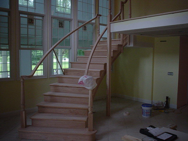

    How is the beam attached to the post that holds up the landing?
    Jon Blakemore
    1. StanFoster | Jun 17, 2004 02:16am | #4
      Jon:   There is a joint right at the bottom of the second level. The 2 x 10 header is bearing on the bottom post/
