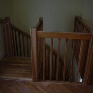

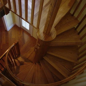

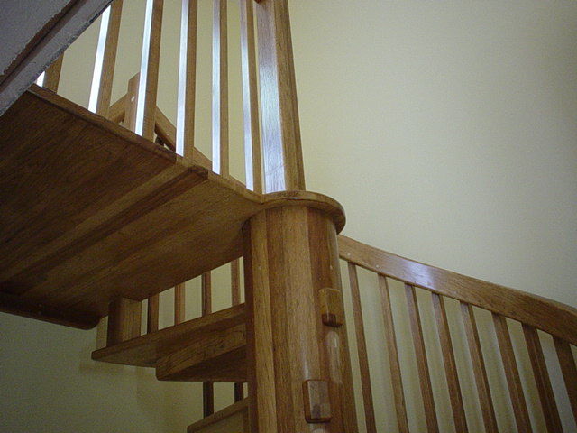

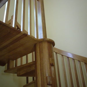

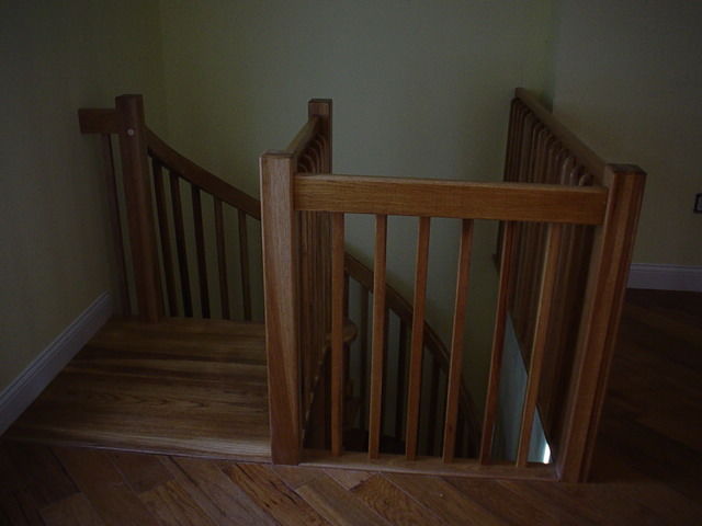

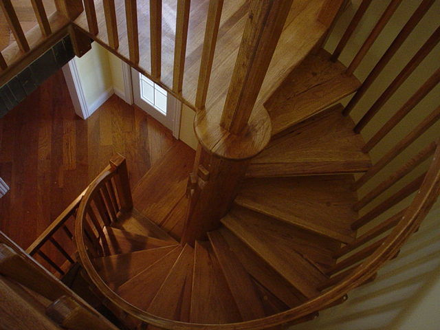

I finished the two story hickory spirals.  The remaining plugs are going to be sanded and refinished.   The stainer got ahead of me and stained the whole stairway before all the plugs were in and sanded……

    Very, very nice Stan.  On pic C, is the landing at the top of the stair "floating" with only the floor supporting?  Or am I just not visualizing.

      Hook:    The landing is supported by sitting on the column below, the floor,  and a wall cleat that is glued and screwed underneath.
