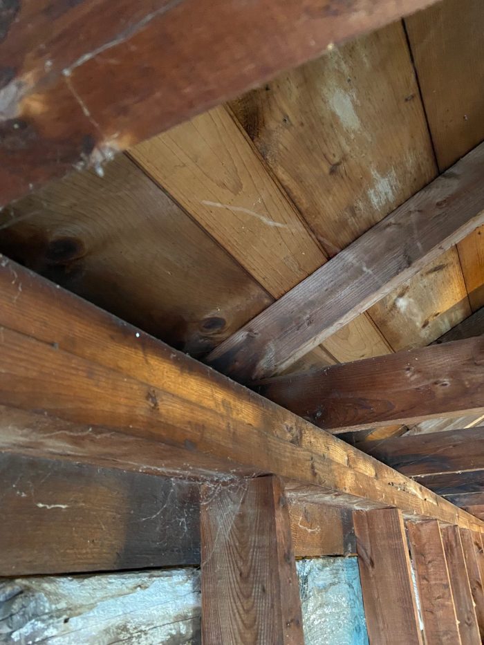

As a result, I would like the insulation and sheetrock layer to be on the underside of the roof so I can leave the ceiling open as it is now for higher headroom between the framing.
Some photos of the ceiling/roof framing below. There is original board sheathing and relatively new (2 years old) asphalt shingles on the roof.
