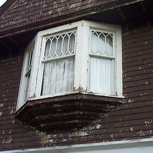

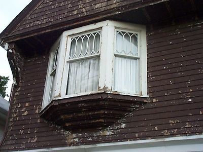

    I've just refurbished 6 casemant windows from 1915. They were busted up and stored in the basemant since someone replaced them with Double Hungs that fogged, and failed.
    Yes it was a pain, yes they are single pane divided lite, but one thing I did to merge Old and New was replace the use of glazing putty with glass stops instead.
    Geeen? who cares, it's a catch phrase for salesmen..what I do is consider will these wndows last another 100 yrs?
    Almost every project on this particular home , is returning to what was original, and removeing the alterations that seemed like a good Idea at the time..and when a new product seems appropos I'll use it.  I ask myself, "If they HAD this type of _____back then, would they have used it?" 9 times out of 10 the answer is yes, and if they had used it, I wouldn't be doing what I am doing..thats green to me.

      Sphere,I would be interested in the details of your "glass stop" technique. I have quite a few older windows to reputty. Are you using a wood trim piece instead of putty? How do you seal it to keep the water out?Thanks.
        Sphere | Feb 27, 2008 01:57am | #6
        I use Azek ( can't locate the thread I did just yet) and milled it to 1/2"x 5/8th" at 36 degrees , glued in with Big Stretch caulk and stainless steel 23 ga pins.
        I bedded the glass, (no points needed) in the Big S, and mitered the corners of the Azek stops with hand miter trimmers ( avail at Lee Valley) and a bench top Lion type miter trimmer.
        A small bead where the azek meets the wood mullions and muntins , and pin away.
        I pre primed the sash. Then any trimming of "proud" azek above the muntins was done with a sharp razor knife, and finally SW Duration paint.
        I had arch top glass segments, I made a heater with a heat gun and Iron pipe , made the azek, bend like putty.

          Thanks for the info. It seems like a more sane solution than puttying. Since the caulk is behind the stop and not exposed it should last a long time, as long as it can handle the temperature movement of the azek. Can Azek (or similar) be painted a dark color?
            Sphere | Feb 27, 2008 02:14am | #9
            Here's the deal. Azek willout last any putty that is not painted regularly, and much easier / faster to install AND replace if a pane breaks. It is re-useable. Just cut and pry and remove the old pins..these sash are 30' up , in dormers..not likley to be maintained.
            Big S caulk will aallow movement, it never gets hard.
            Azek is noy supposed to be painted dark , but that is in a mode like fascia or large trim..in this case, a 10" pc. that small, can't possibly expand /contract enough to cause concern..I tried it with black primer and set some in full sun..a smidege maybe a few .001's of change.Spheramid Enterprises Architectural Woodworks

            This is such a great idea that someone could make a fortune marketing a kit with precut azek pieces and caulk bundled with instructions.
            My concern is that I have sections of my window that meet in a point at the bottom. If not 100% sealed at this joint the water will get in at the bottom miter joint. I supposed I could use PVC glue to fuse the joint at the bottom.
            Sphere | Feb 27, 2008 03:47am | #12
            A dab of the Big Stretch at the miter, AND a big AND, a Good painter knows that the paint has to be over the juncture of the putty and glass, so is true with the azek stops.  A film of SW Duration or Porter's Permanizer is like what I call "Liquid Caulk".
            I purposely paint onto the glass, and when razor blade clean up time, leave a seal there.
            But really, I can't see how it is any worse than failed glazing putty that often does more damage being removed..
            On these particular sash, the putty that wasn't decayed, was FIRMLY attached to the muntins, and had to be heated and chiselled out, and some wood was affected adversly in that process.
            So, take your pick..make it water tite, or fight with the glazing later.Spheramid Enterprises Architectural Woodworks
