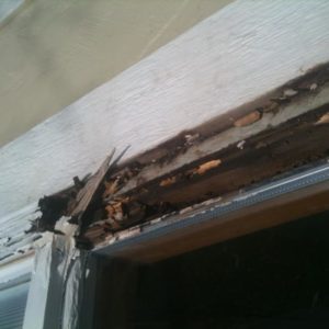

  5. John316 | Nov 24, 2009 07:02pm | #5
    Here are some more pics (sorry for the delay). On the two of the casement that is rotted out really bad, it looks like I didn't get the eave (or no eave on that part) in the photo.
    Do you have any ideas what might have caused the rot? (it is highlighted in the photo with red blocks)

    1. PatchogPhil | Nov 24, 2009 08:24pm | #6
      As previously stated, there is more rot/mold? underneath the surface damage.I wouldn't want to be the person buying that place with only the new lipstick covering up the hidden damage.And that is a phrase and a half... "covering up".Will you be fixing the underlying problem(s), or just involved in the cover up operation ?

      1. John316 | Nov 24, 2009 10:06pm | #9
        Hi there,Thank you for your reply. When I pulled those boards off, there was almost no other rot and certainly no mold that I saw in the siding or framing. Right above the garage door, the siding was rotted out there, and I replaced that with hardi.Whenever I was able to see framing, I always checked to see if it looked rotted or moldy, and it always looked really solid.Thanks, J
    2. calvin | Nov 24, 2009 09:53pm | #7
      Most of your red blocks in photo 4 are at cuts/intersections in trim to trim/trim to roof.  Unpainted when cut a sure spot for sponging water up into the end grain of the trim.  Had they painted when they cut and b/4 putting it up-might have helped.
      Beveling all horizontal members and cutting trim to in on bevel helps also to shed water.  Hardly done anymore.
      Nailing trim over siding grooved or not is another sure fire way to introduce water behind trim.  Quick install-problems later.  Pay now or pay more later doesn't seem to phase 'em into doing it right in the first place.
      The bottoms of the sash indicate a lost seal from the glazing to wood.  Any idea if these were Craftline or ..........damn, name escapes me......windows.  A couple brands I've seen unclad sash were notorious for failure even after 7-8 yrs.  Crapline being one-no longer in bizness-no wonder.  Some of these had marginal seals-usually small vinyl cut short.  Some relied on other methods of seal-done incomplete.  Openings just waiting to capture every drop that went by.
      In 89, Marvins had some bad wood treatment that let to unclad failures like yours.  However, I believe thay had changed suppliers by 93.
      Believe me, if you scour some of the 70's, 80's and 90's neighborhoods you can come up with whole blocks of decay.
      Painters keep caulking and painting, never opening their mouths.  When they do, some of the fixes are just to the areas at the decay, never looking for the source.  Another 7 yrs and the repairs fail because of the lack of investigation and correction.

    3. YesMaam27577 | Nov 24, 2009 11:49pm | #11
      >>"Do you have any ideas what might have caused the rot? "Yes, I do.Water.Water is getting in someplace where it should not be able to get in.And that same water is unable to get out through the place where it should normally be able to get out.I certainly can't speak to the details of all of the areas that you highlighted in your picture. But you showed the bottom corner of a window, which had rot to the sash, the exterior sill, and the apron.I'm just guessing here, but I'd bet that the water is actually entering at the top of the window -- or maybe (but not likely) halfway down the side. It then runs down the unseen side of the jamb, and tries to get out when it hits the flashing pan beneath the sill/stool.But something tells me that there is no flashing pan, and even if there is, that the underside of the sill has been caulked thickly -- and that is what is keeping the water in.
      Is there proper drip cap above the window's top trim? Is the horizontal seam in the T-111 siding properly flashed with Z-strip?Has the drip cap or the Z-strip been improperly caulked?Is there any way to know if the windows have any flashing at all on the sides?I won't be laughing at the lies when I'm gone,

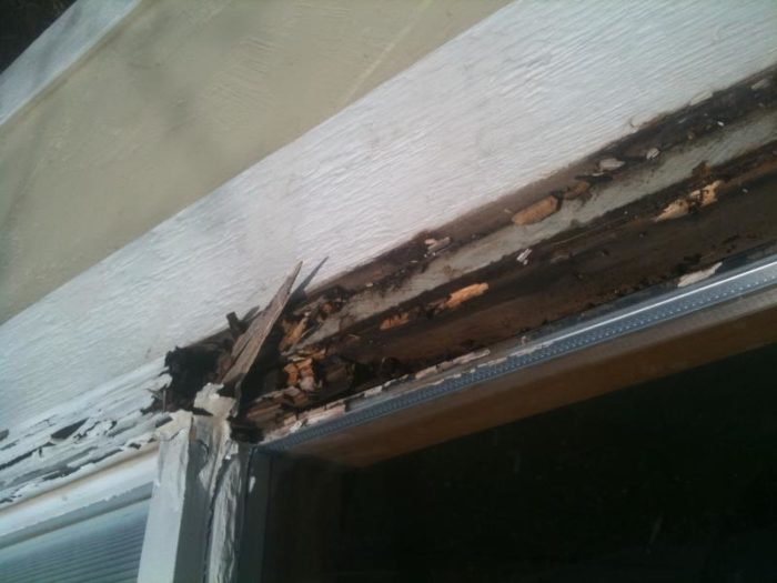

      1. JDale | Nov 25, 2009 01:06am | #12
        Here is a pic of my lastest rot.  House is about 2 years old, bank owned.  Never been occupied.
        Vinyl siding, sorry excuse for house wrap and no type of flashing.
        1. JDale | Nov 25, 2009 01:32am | #13
          3rd try for another picture
