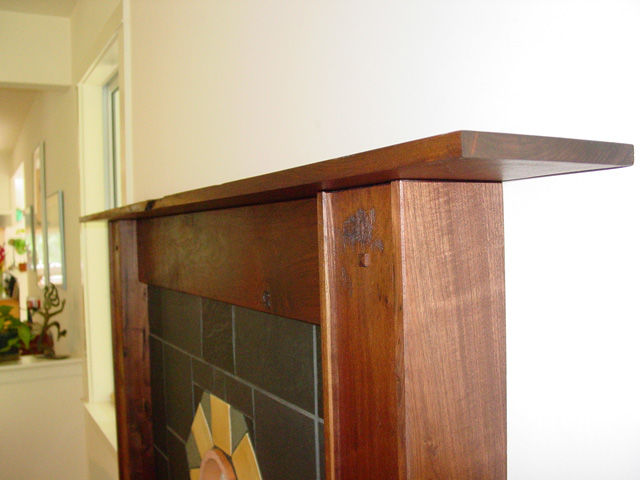

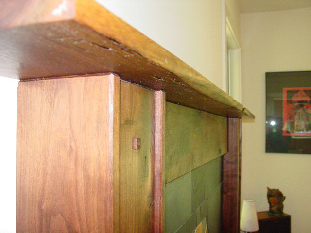

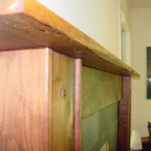

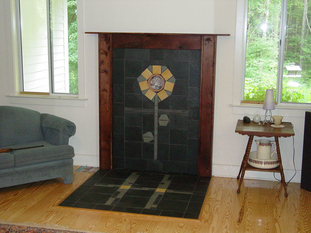

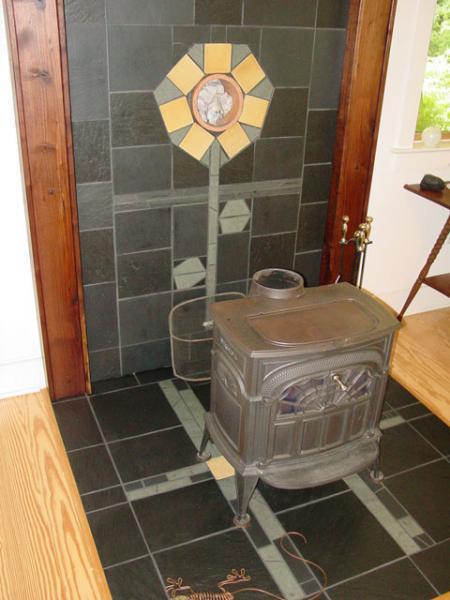

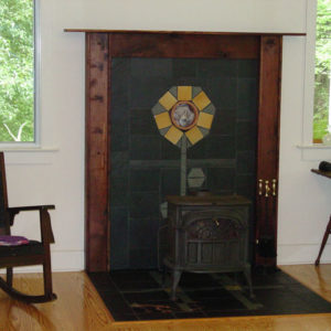

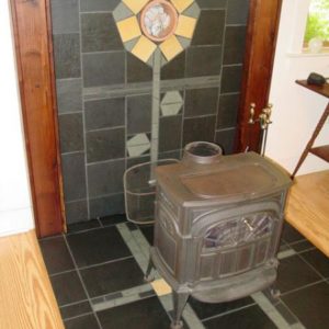

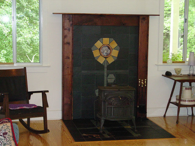

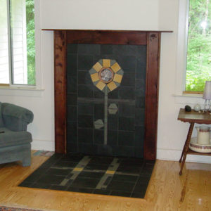

About 4 years ago I posted a question here about finishing our hearth. Well, I finally digested all the great information, and got it done yesterday.LOL

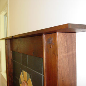

There’s a 2″ airspace (created by hat channel) between the Hardie Backer and sheetrock. 4 flavors of scrounged slate along with a few resawn Mexican tiles. The walnut came from a big logging operation on Ashlawn, James Monroe’s plantation, outside of Charlottesville, VA. I’ve been air drying about 800′ of it since 1978…I hate to rush into anything<G>
Thanks for the inspiration all!

    Looks good, but you're gonna get a lot of smoke in the house unless you add another section of pipe    ; )

      Dang, I knew I was forgetting something in San Francisco<G> Don't worry, we can fix that later!

    Schnort.....schweeeet.......nothing nicer than finally getting it done just the way it always looked in your mind.
    Monroes plantation.....I`m jealous!

      900,000bd' of poplar were logged off his place in the 70's. I was building a green wood oak house, and the guy that was milling it, called and asked if I might consider using cedar instead of white oak for the siding...hmmm. When he delivered it, he mentioned the walnut. He was milling some of the Ashlawn lumber, and nobody wanted to mess with anything other than poplar. That was definitely one of my lucky days.Thanks There is nothing--absolutely nothing--half so much worth doing as simply messing about in boats. Ernest H. Shepard
