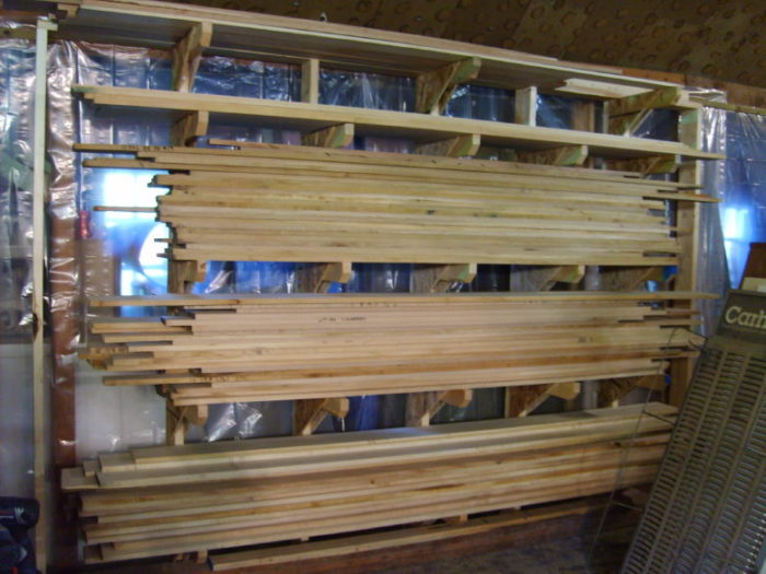

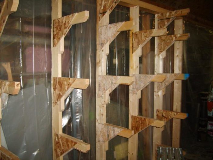

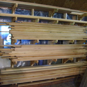

Turned a bunch of scrap lumber into brackets that fit over 2x studs, for use as a lumber rack. Here are a few pics:

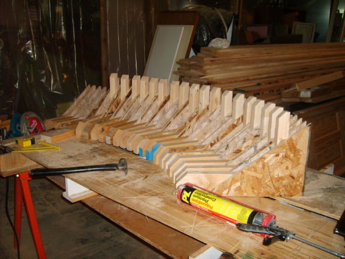

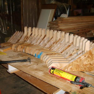

      basswood | Aug 25, 2008 05:48am | #5
      Thanks,I used an EZ Guide and cut 48 gussets out of two layers of OSB in one series of cuts. Here is another pic.

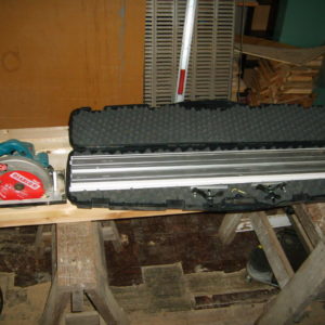

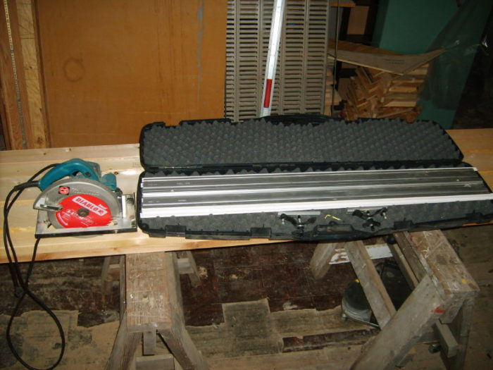

            basswood | Sep 01, 2008 06:56am | #14
            Here are the two 50" sections that fit nicely in a gun case:
            ToolFreakBlue | Sep 01, 2008 07:53am | #15
            that's convenient.TFB (Bill)

  5. woodturner9 | Aug 25, 2008 03:37pm | #11
    Are you attaching that to the framing of the building?  How much are you loading onto that rack?
    The concern is that if you load very much, the load on the building may be more than design load and may cause the wall to bow or fail.  The L brackets have more leverage than you might expect and increase the load a surprising amount.
    I wouldn't suggest loading more than 50 lbs or so total - might be safe for more, but I would need to know the design load of the building and the length of the L brackets to calculate the safe load.
      basswood | Aug 26, 2008 06:11am | #13
      These racks are loaded with about 150 lbs per level (30-50 lbs per bracket) and roughly 500-600+ lbs for the 12' section of the wall.The shop building is a Big Band Era dance hall and the racks are at the edge of the old dance floor below a barrel vault with a 24' span. The arched ceiling has, over time, flattened out slightly, and caused the walls supporting the vault to bow out in the middle. The load on my racks will only help resist this outward push.
