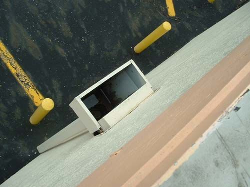

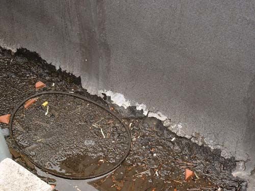

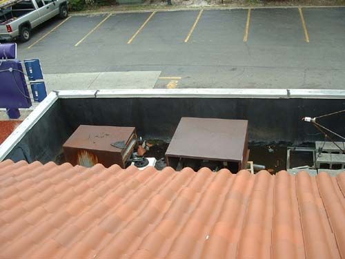

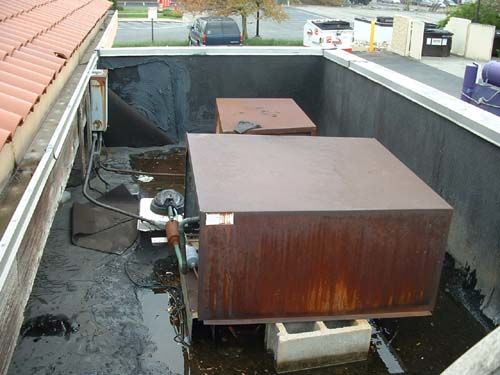

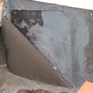

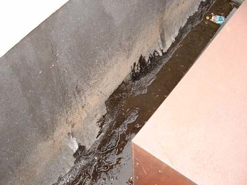

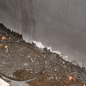

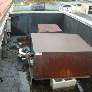

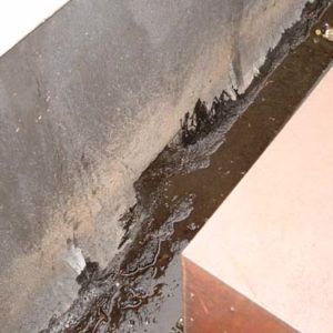

      PeteDraganic | Jun 14, 2008 11:18am | #14
      Here are pics of the roof from various angles.
      If you have questions about what you are looking at in any pic, just ask.

      1. DaveRicheson | Jun 14, 2008 02:31pm | #15
        Piffen and IMERC will be back to reinforce how bad that roof really is.
        Meanwhile I'll hazard a suggestion.
        It doesn't look like those units are mounted on proper curbs. Just setting on block and doing a mini vibration dance every time they run. Propably eating holes in the roof right under each block and wallowing out the pitch pockets,if there are any, where the lines penetrate. Whatever you do won't last your warrenty year if you don"t get those units set on a proper curb, secured, and flashed.
        I can't tell from the photos if there is a cant strip beneath the roofing material at the parrapet wall/roof corner. That is a good area for shrink cracks to form as the roof ages. The lack of a cant strip in the corner also means there is no support for the roofing material as it transition from the flat to the vertical on the wall. That sharp bend means the material was doomed to fail. Ever try to bend a piece of 30# felt into a 90 degree corner?  It may look ok on the inside, but the back of the felt is cracked, leaving only a small layer on the front to do the job the whole piece was suppose to do. A few years of age or someone stepping close to the corner will finish splitting it open. The  guys mopping in the tar, just slop over it and it holds for a few years.
        I would bail on this one, or charge high enough that I could afford the call backs I would get over the next year or so.
        BTW Tremco has a plant and office in Cleaveland. Give them a call. They may give you a free expert eyeball and suggestions for a chance to sell you thier products.

      2. IronHelix | Jun 14, 2008 02:52pm | #16
        Pete,
        That roof is a mess!
         Look at the pic that shows the side of the concrete block supporting the cooling unit. It appaears that the water level has stained the block up several inches indication that the scupper exit elevation is too high.
        The parapet sidewall junctions to the roof surface seem to have deteriorated, as well as poor repairs to the parapet sidewalls themselves.  And as previously noted--the HVAc "curbs" are not standard, but a poor man's use of poor materials.
        The flat surface areas look to be "mealy" and already degraded past the point of repair.  Application of any gooey product would almost fail in a very short period.
        That mechanical roof area needs a total rework.  If I had to do a patch job, there would absolutely no warranty...all call backs would be T&M.
        The RTU's need to be maintained also.  What a poorly designed mechanical area!
        Looks like a fastfood drive-up type place...if they can not afford to fix this then I would assume they are running on the financial edge of closure! IMHO.
        Glad it is you and not me!  Stick to your guns..professionally.

        did you climb up the clay tiles for that last pic?
        Anyway, you need a new roof there. Or buy a few 5 gallon buckets of geocel 2315 and dump it out schmear it around, it mixes with bituminous by solvent action and makes a real mess if yer looking for pretty, but in this case may just buy ya some time.Spheramid Enterprises Architectural Woodworks

          BTW, didn't have to climb the tiles.. there is another flat roof above but it is covered with white PVC sheet roofing.... I don't even know what the stuff is commonly called.  There are some failed flshings and stopped drains up there that require my attention as well.

            There is a polyester scrim (cloth-like material) that one can lay down over a really bad area, seam or imperfection before applying the coating.... frankly, my understanding is that you can essentially lay this over anything if you do it correctly.
            I will be using a 12" piece to reinforce the curbs along the parapet.... and to build a few flashings.
