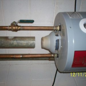

Is it ok to use aluminum foil hvac  tape to connect the vent pipe to the top of the heater?  I don’t have a picture of the finished product, but here is a pic of the problem.  The pipe pulled loose, and they stuck it back in place and wrapped it with tape.  Seems to me that the heat would cause the goo to breakdown pretty quickly, and then the joint would open again.

    Note that the flue pipe in question is galvanized (as req'd), not aluminum. That should answer your question.

      Obviously there's more to the story.  The heater is in a finished basement.  It was moved by non-plumbers who were doing other work in the basement, and they did not reconnect the pipe when they were done.

        I think since FastEddie asked if Aluminum tape was ok, MikeHennessey said that only galvanized pipe is ok, therefore aluminum is a no-go

        Don't have a book in front of me -- it's under my water heater ;-) -- but I'm pretty sure code specifies steel, stainless or galv, for flue pipe. I assume because Aluminum will melt/deform at such a low temp and quickly corrode from the flue gasses.

    3 sheet metal screws.

    I was told in the past 2-3 days by a Home Inspector that tape is NOT allowed on flue pipe joints.
