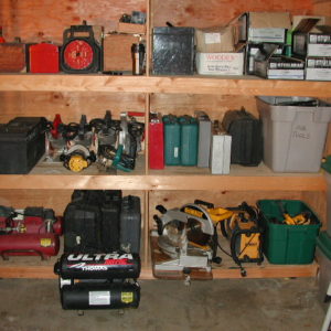

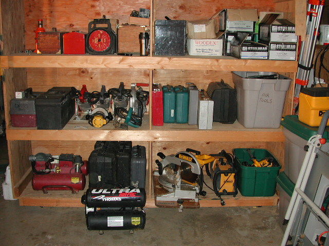

    Depends on what you plan to do with the compressor.  If you are doing small trim jobs around the house then a small one will work fine. If you plan on building an addition you might look at a larger unit.

      Im with heck, you are WAY to organized to be a carpenter

        Heck and CAG,
        Don't tell him I told you this. If you do, I'll deny it...
        I've been to Bob's house. He ISN'T that organized. He's a regular guy like the rest of us. That picture was taken the one time in twenty years that he cleaned up and organized. It's for posterity.
        Of course, just like the rest of us, he has enough posterierity for two normal guys. hehehe But don't tell him I said that, either. He's liable never to invite me over again.
        Hey, he has a WELL-STOCKED fridge in the garage. Anyone lucky enough to be able to windge an invite out of him won't go thirsty. But you gotta watch that cat of his. He'll try to crawl in your pocket and go home with you. I don't know why. Maybe Bob just doesn't give him enough attention. Or doesn't feed him enough. Poor cat...

          OK Luka- You weren't supposed to tell. Now I've got to go out there and clean up my mess again.
          The fridge is usually full till the sons come over and clean it out.
          The Cat?? who Knows??

            I HAVE been to Bob's house a couple times. Everything that I could see there, was basicaly just as you can see in the pictures. It's a beautiful place. I was and still am, in awe of not only his ability, but his talent. Dude's a modern day Rembrandt. (And I don't give up that sort of title easily.)
            The tools, were also, basicaly as you see in the photo. The only difference being the tools that would be used in a single days work, were put back quickly, and some even on the floor. Exactly the way they would be by anyone else, at the end of a day, when you are already tired to the bone.

            Okay the cat is out of the bag. For YEARS Lars has told me that a mans tools are to be used. Why put them up when you are just going to use them again. His shop is TERRIBLE! He doesn't want me to touch it and many have offered to help me. Can you give a class or something to help people like him? You could retire from your day job. Many wives would hire you;-)Tamara

            LOL Tamara- Keeping tools in order is not all that hard if you only do one thing day after day. The problem arises when we are asked to do multiple things like, "when you get home from work would you.......................
            scrape the popcorn off of the master bedroom ceiling, it's the only room left to finish?."
            Sounds easy enough.
            1. move the furniture out, disassemble the king size bed,push,pull and drag the mattress into the other spare room.
            2. spread and mask plastic over entire room.
            3. fill pumpsprayer with water, duct tape 10" taping trowel to broom handle, spray ceiling and start scraping. Now that it is all stuck to the bottom of your feet you're stuck in the room for life.
            4. Break out the taping supplies and skim coat the seams with topping compound
            5.Sand topping compound
            6. Roll up all the mess and break out all the tools for putting up the crown molding-chop saw,compressor,pinner,caulk,Onetime.
            7. Put all that stuff aside and break out the paint supplies- rollers,pan,brushes,tape,tarps,you know the drill.
            8. three coats flat white on ceiling,two coats dark Khaki under chair rail two coats lighter khaki on upper walls.
            Two guys four days later and the furniture is ready to go back in. Now the garage where I keep my tools looks like a bomb went off.
            I'll clean it up later, I'm too tired right now. :-)

    And Bob, how can you keep things so neat??

        That picture is the result of living in the Rain Forest. After the first few weeks of daily rain you run out of things to do......
