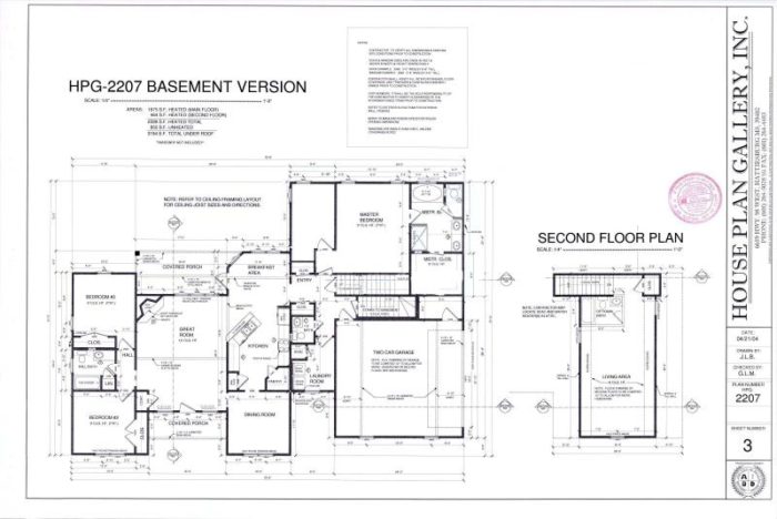

~2020 square feet on the main floor (note the square footage on the floor plan isn't correct but I didn't have a scan of the current version)
~650 sq ft in the bonus room over the garage

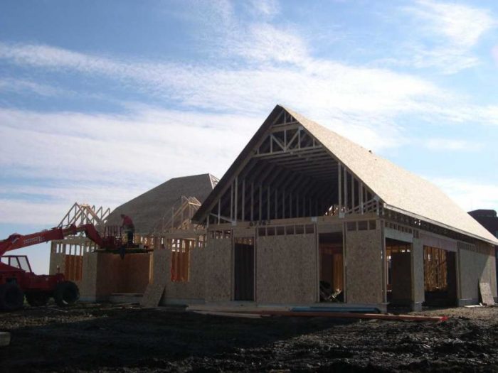

Let me expand on what was in that lumber package number. Framing lumber, trusses and floor system, roofing materials, siding, drywall, composite deck materials, materials for closets and built-ins. Not counting trusses and TJIs, framing lumber was about half the amount.

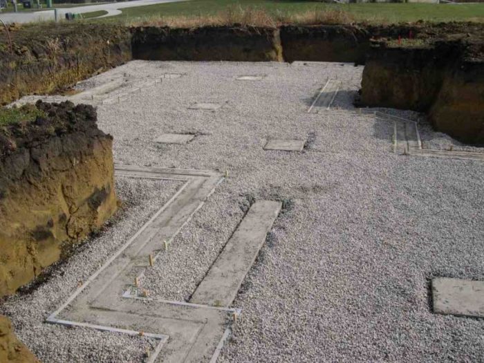

Can you do the same for the foundation number? Your excavation number seems low to me, and maybe your foundation figure includes all drainage, waterproofing, flatwork everywhere, insulation, backfill, finish grading, etc.
Stinger,
Foundation price also included drainage (Formadrain), gravel, waterproofing (Rubberwall), basement floor, garage floor, front stoop, and two 4'x6' poured egress wells. The price for the walls was a bit higher due to the floor plan being so cut up. This probably added an additional 15% to the price.
Excavation price included scraping off the top 6" or so of black dirt off the lot, excavation for the foundation and garage, backfill and after the drive and other flatwork was in, spreading out the black and doing a rough grade and hauling away extra fill.
Finish grade was done by my landscapers and in the sod and seed pricing.
