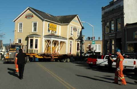

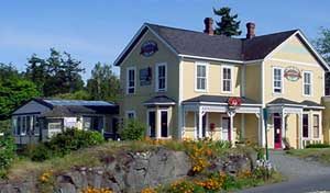

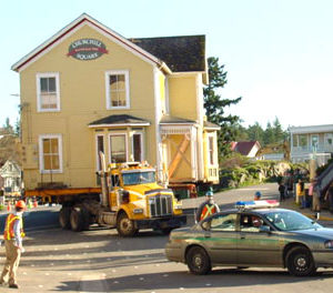

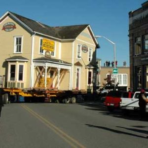

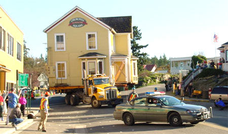

A historic old home was moved from one site to another here in town yesterday. Nickel Bros. House Movers of Victoria BC did the job and made it look effortless. They moved the building about 6 blocks, but had to use a longer route due to narrow streets in some areas. The route started with a downhill  into a left turn, and was either flat or slightly uphill from there.
First they jack the house up, then they get wheels under it. The rig they used was very slick. It’s a large semi trailer that is in two halves, a right and a left, and has crosspieces that tie it together once the halves are in place under the house. Each corner of the rig is hydraulically adjustable so that they can keep the building level even if the street isn’t. The driver gets instructions via radio and hand signals, and moves at a crawl. I could only hear the engine idle, it seemed like he never stepped on the gas once, and the whole thing moves at a slow walking speed. He wove back and forth down the street to swing the house past the cobra-head streetlights.
The house is on its new lot now, on cribs. They will come back and lower it once the  concrete is in. The price for the move was ~$48K.
