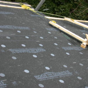

        1. ponytl | Dec 06, 2003 04:56am | #8
          not sure what the stuff was... but like felt... but for roof underlayments   comes 10ft wide... can stay on for months... is stronger... holds nails well... and priced right... I've never seen it used... think i saw it in FHB  or maybe here in a post... could have seen it on TOH... maybe at a supply house...?  anyone?  would it be good as a house wrap?
          pony
          1. xMikeSmith | Dec 06, 2003 05:47am | #9
            yur kiddin , right ?
            u mean RoofTopGuard II..Mike Smith   Rhode Island : Design / Build / Repair / Restore
          2. ponytl | Dec 06, 2003 09:08am | #12
            yep that looks like it ....  I haven't seen it used around here...  but it looked like good stuff...
            my supply house does sell a product thats made from old tires... thinner than 15lb felt  but very strong...  comes 5 or 10sq per roll... i don't get into that type material ... all i buy is torch down...ply material & kegs of tar
            p
