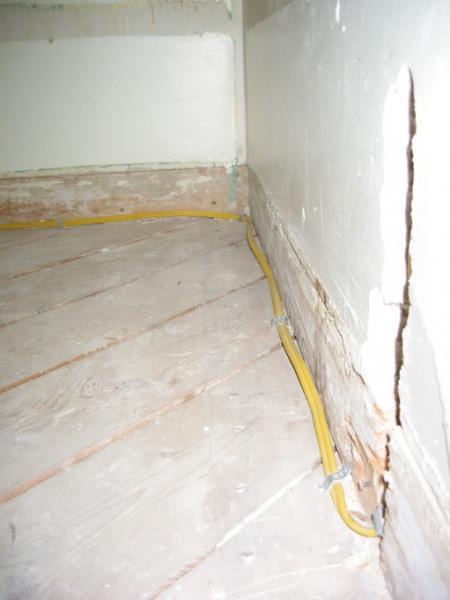

Kitchen reno underway at my mothers home. This was the electrical after the first day – looks unacceptable to me but I’d like a second opinion. The ‘Electrician’ was a young kid who kept calling his boss for advice?

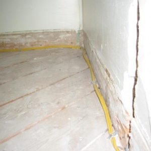

(Photo “baseboard.jpg”) First wire he ran up through the floor at one end of the kitchen then ran it along the baseboard all the way around to the other side. It’ll be under the kitchen cabinets so not too bad, but it would have taken 2 minutes to run it under the floor. Directly under is a hung ceiling in the basement – there’s room for the wiring to run under all the floor joists and above the ceiling – they cut enough holes in the floor to make this easy.

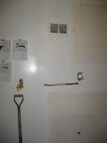

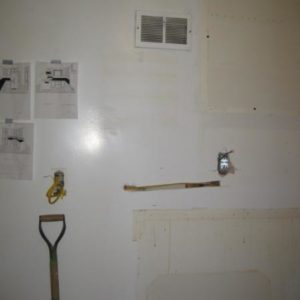

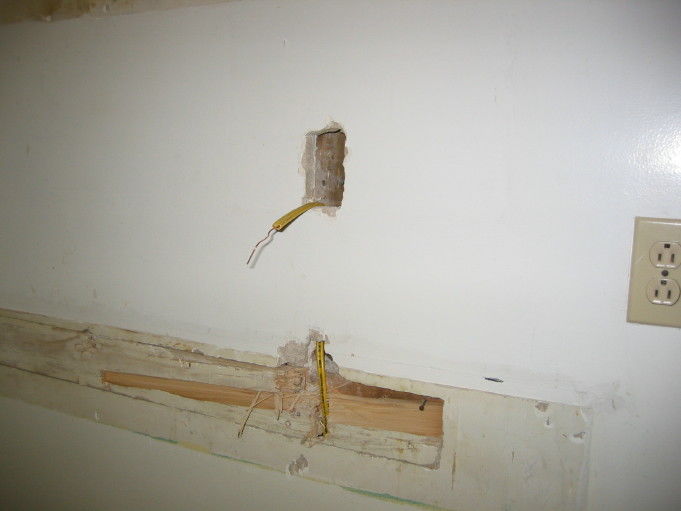

(photo “around.jpg”) Then he wired up the outside of the wall instead of drilling through the sill plate and up through the center of blocking notching every time he hit a stud – when I check now all the blocking already had preexisting holes except the sill plate. That’s about 30 seconds work?

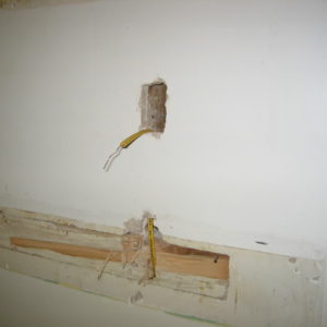

(photo “outandover.jpg”) To move a plug over 3 feet he cut the drywall open and ran the wire over the studs again. There’s a pre-existing duct in there but it’s being replaced in new plan so it’s nolonger functional duct work. He could have drilled 2 holes and ran the wire internally? I assume that he’s going to join the old and new wires in the old box and then cover it over. It’s wrong to close in a junction box, makes it hard to fix if the wires have a problem? What should he do here?

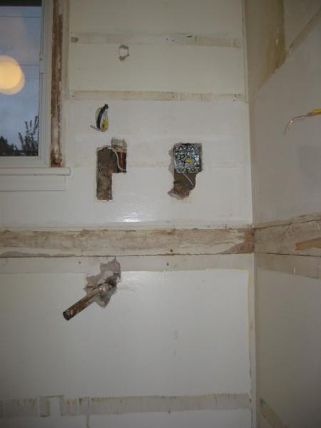

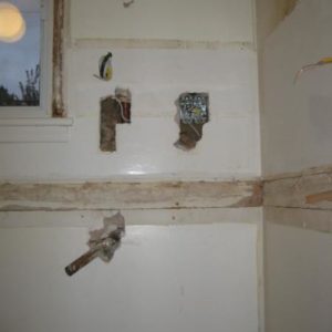

(photo junction.jpg) The idea here was to keep the switch for the light over the window and add an outlet. when he opened the wall he found the old copper stack for the sink (which will no longer be used as the sink is moved to the other side) so he decided to move the switch and outlet over one bay. I’m guessing he plans to join the wire at the old switch and maybe or maybe not put a junction box and enclose it. Again not the best.
I plan to go speak with him in the morning about the quality of work. I’m thinking it should all be redone (he can be lazy and leave the wire under the cabinets, but that seems pretty pathetic). Can someone give me advice on this.

    1) I agree the work leaves a lot to be desired.  Wires should not be run in front of the studs.

      Thanks for your views on this. Just one point of clarification - for the wire along the baseboard, the plan is to put down plywood on the floor. I'm guessing his idea is for the plywood to come up to the wiring but not cover it. If this is true than the cabinet guys would be able to lay over the wire because of the height of the plywood. I know they need to lay down plywood - the rest is just a guess! Still seems like a poor job given running it through the floor would be easy.Thanks again.

    I don't know what the electrical code says about running wires along the floor in back of the cabinets but I don't like it. it speaks of laziness and poor quality. (just my opinion). as far as the wiring with all the notching around the fireblocks. be sure to add some nail gaurd plates over those wires so as to protect them against any unsuspecting screws and nails from others who don't know that there is a wire behind the sheetrock afterwards.

    Only obvious issue is the lack of nail plates where the cable crosses the studs.
    It isn't the way I would run the cables but as long as he complies with code and gets it to work while making it presentable you really don't get to chose the routing.

    Note on styling - the new outlet (hole in "around") is at a different height from that of the existing receptacle, which really looks sloppy and careless.
