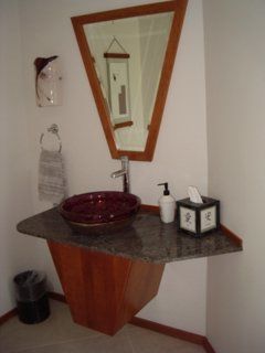

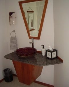

  7. mikeys | Oct 19, 2003 07:44am | #10
    I've hung a couple of bath cabinets this way. Build the cabinets strong with 3/4" plywood backs. The back and sides must be well secured together. Screw them to the wall. You'll want good fasteners to the brick. Don't tell anyone, but since I was attaching to drywall over 2"x4" studs and the lumber yard didn't have 2"x4" screws,I used drywall screws.
    Smile. It could be worse. You could be me working for you.
    1. mikeys | Oct 19, 2003 07:55am | #11
      I know this cabinet is small but it's supporting a big piece of granite.Smile. It could be worse. You could be me working for you.
