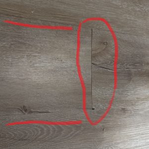

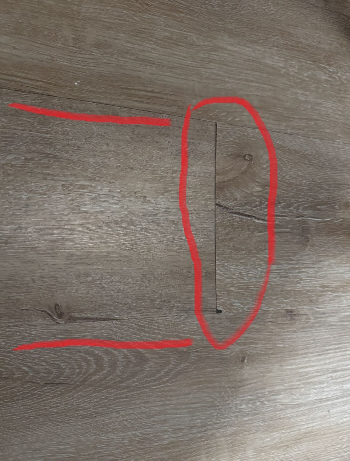

As shown in the picture, some areas of my floor have risen. The edges along the two red lines I drew are all raised, especially in the circled area. If children or elderly people don’t notice it, they could trip and fall.
This issue may have been caused by the computer chair I placed in this spot, as prolonged pressure seems to have caused the floor to lift.

  1. calvin | Nov 20, 2024 12:08pm | #1
    A little more info please?
    Is any of this flooring tongue and groove? Edges and ends?
    Where did you put this glue?
    Now that the glue has hardened, do you figure you have filled a gap below the flooring and now there’s no way in hell you’ll be able to bring the raised pc. down?
    Is there a subfloor below this flooring?
    Are there any heat runs below this area.
    1. Floor | Nov 20, 2024 11:56pm | #3
      Is any of this flooring tongue and groove? Edges and ends?----Yes
      Where did you put this glue?---I applied the glue along the seams of the floorboards at the time.
      Now that the glue has hardened, do you figure you have filled a gap below the flooring and now there’s no way in hell you’ll be able to bring the raised pc. down?----I can still press the floorboards back into place as there's no dried glue inside preventing me from flattening them with heavy objects. However, as soon as the weight is removed, the floorboards lift again.
      Is there a subfloor below this flooring?-----I belive so. but I can not confirm.
      Are there any heat runs below this area.----No.
    ct_yankee | Nov 20, 2024 07:38pm | #2
    To add to Calvin's question - what type of subfloor sheathing is under the flooring? How thick?
    Could possibly be connected to excessive deflection of the subfloor resulting from the concentrated loads of your chair's casters.

    mistered1957 | Nov 22, 2024 01:34pm | #8
    This flooring looks like inexpensive floating laminate wood flooring, such as Home Depot's TrafficMaster (99 cents/sq.ft.). This product needs to be installed over a very flat, strong subfloor, or else bad things happen at the joints. TrafficMaster has a particularly fragile joining system that is very easily damaged. Also, each piece, as it is installed needs to be tapped together with a piece of scrap flooring (aka banging block) to ensure the seams are joined, and then each piece needs to be lightly tapped with a rubber mallet from above to lock the joints.
    I'm guessing that, in your situation, the tongue and groove joining system was damaged at the corners, and that there was extra stress on that joint from the joint damage and the stress of a caster, which certainly amplifies the stress on the floating floor. Also, these floating floor products don't like being "pinned" by heavy furniture, cabinets, appliances, etc.
    I'm thinking that the repair would involve cutting out that piece with an oscillating multi-tool (a cut down the middle of the plank's length, with two "Y-cuts" from each corner of the piece back to your center cut). You can find YouTube videos on this technique for luxury vinyl plank (LVP) flooring. Once the plank is removed, you'll probably be able to identify the root cause of the problem, and glue in a new plank with grooves altered as shown in YouTube videos.
    Alternatively, buy a "hard floor chair mat" at Staples, U-line, Amazon, etc. to cover the floor, spread the weight of the rolling chair, and minimize additional damage.
    As mentioned previously, calling your landlord might just be the best first step!
