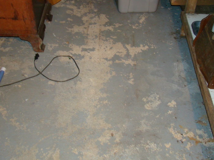

    Try using a penetrating concrete sealer on your floor -- DryLok and other coating paints will not be enough for the wear and tear they'll be under.  I've attached a picture of a floor with a waterproof paint applied -- it's obvious where it's been peeling off.
    A penetrating sealer may also be able to resist any stains from spilled materials on the floor, and will make the floor a lot easier to clean.   It's durable and shouldn't come off under normal wear and tear conditions. It also shouldn't change the appearance of your concrete floor, and it will keep it looking good for a long time.
    1. calvin | Jun 20, 2011 08:45am | #10
      ray
      Tell us how your sealer keeps the weeping concrete from releasing moisture up through the slab.
