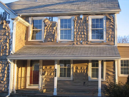

I like that picture. Sort of a "What would have happened if Salvadore had chosen construction for his vocation"

Your tag photo made me realize how that vinyl must have melted. The neighbors had a fire burn their house down and the radiant heat from it was more than it could tolerate.
No kidding! I can't leave it up on my screen for fear of sunburn.
You guessed right. The house across the street went up and the heat from the fire did that to the vinyl in the photo. Frightening when you think about it....
I got that pic from Dan Morrison at the mag. Somebody sent it to him as a gag after Mike Guertin's infamous article on how to install vinyl siding.

Lord Almighty! How did that come about?
The only worse thing than vinyl siding is black, burning, toxic vinyl siding.
What my firefighting instructor lo these many years ago used to call 'methyl-ethyl-badshït'....
