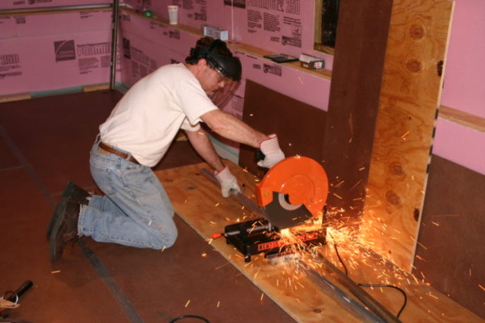

I've never used metal studs, they just don't look like as much fun to assemble.
[darth vader voice]"Come, young Skywalker, come over to the dark side." <g>
It can be very cool, though. No miterbox, just a pair of good, sharp tin snips (handed if you prefer). And a bucket of fraining points (self-drill, self-tap, 3/16" SM screws).
The top & bottom tracks are the key. A good laser for layout too.
No sawdust, no saw noise, no air hose run through the client's house--can all be good things.Occupational hazard of my occupation not being around (sorry Bubba)
Or if you have heavy gauge studs that are too tough to snip easily, you have to enjoy the noise and fire of a cutoff saw.
It sure doesn't smell like wood, though.

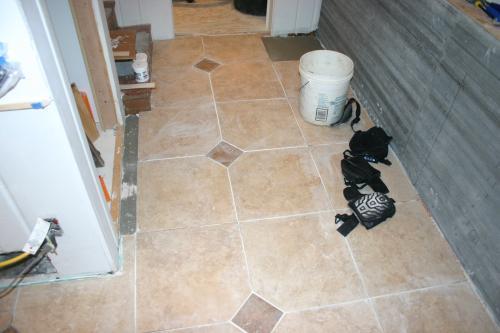

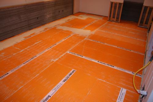

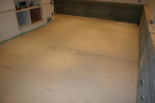

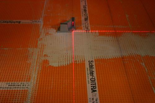

Hi Justin,
The room with the Masonite on the floor didn't get the foam floor treatment because the floor covering is porcelain tile, with a NuHeat radiant heating mat underneath. EPS or even XPS foam probably has too much deflection to support a tile floor surface, although it would have been possible to use foam core Wedi board like they do in Europe for radiant floor installations. The floor was leveled with a mud bed and the Masonite protects the surface of the mud bed during construction and before tiling. The walls were lined with XPS before the mud floor was put in and the steel walls were built on top of a Trex plate fastened to the top of the mud bed. Building Sciences recommends using foam insulation between steel walls and the floor to minimize heat conduction through the steel framing and possible condensation or ghosting issues.
There is Ditra under the floor tile and Schluter claims that the channels in the Ditra allow water vapor to escape from the slab (but I'm a bit skeptical about this claim). Anyway, water vapor transmission through the floor is greatly slowed and the heating mat raises the temperature of the floor surface enough so that it will not be a condensing surface. It will take the edge off of a "cold tile floor" and it is not meant to be the primary heat source for the room. With the tile you don't have to worry about mold and the other problems associated with installing carpet in a basement.
The bottom three feet of the walls is finished in cement board as a fire barrier for the foam, and it does not support mold growth. Wood T&G will be installed over the cement board as a wainscot. The most important detail is there will be a wide chair rail on top of the wainscot -- wide enough to set your beers on top. Every basement needs a lot of surface area for beer bottles when you're having a party. :-)
You do everything you can to eliminate water issues in a basement, but it's still worthwhile to use smart construction so that a sewer main backup, broken washing machine hose, flooded window wells, or a heavy rain after an icy snow that freezes in the gutters and clogs them so the rain pours over the gutters (as happened a few years ago) or other "basement water event" don't ruin your day.
I'l try to post some photos of the NuHeat, Ditra and tile installation later tonight.
Billy
Edited 10/6/2006 9:33 am ET by Billy
Here's the Nuheat, Ditra, and tile on the floor.
