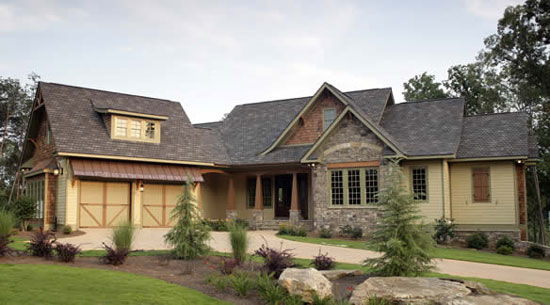

How long to bid something like this?
Gene_Davis | Posted in Business on May 25, 2008 12:18pm
Story and a half something like this, complete finished walkout basement makes it about 4200 sf finished, plus finished guest apartment over attached 24 x 28 garage.
From plans and specs receipt, how many working days might it take you to deliver a lump-sum firm-price proposal?
