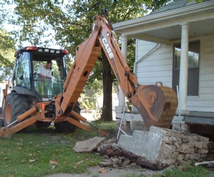

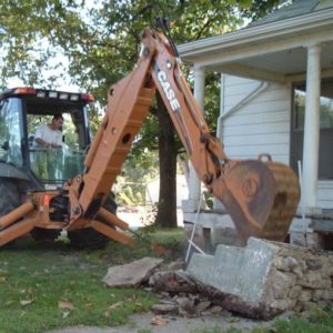

        BossHog | Aug 20, 2008 03:20pm | #14
        This is my preferred method.
        As someone else said, they may break up with a sledge. Especially if they were filled with rubble like these steps were.
        I got the backhoe because I didn't want to load all the busted up stuff into a truck by hand in order to dispose of it.
