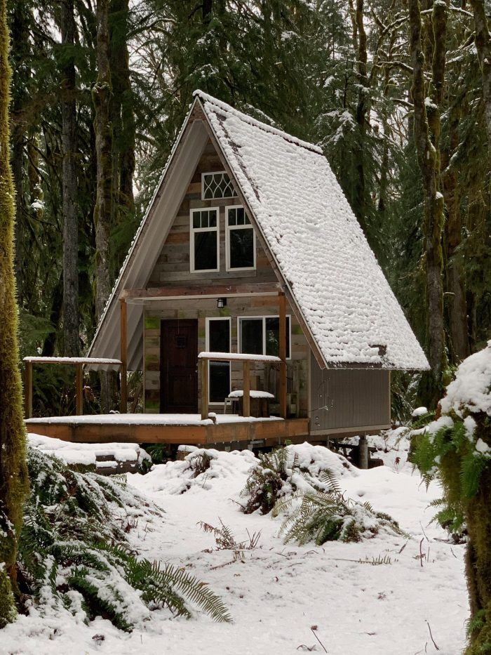

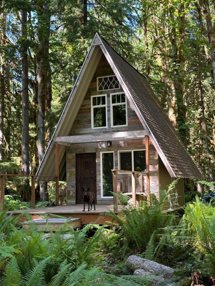

I have a small recreational A-frame cabin in Baring, Washington. This is in climate zone 4, right near the crest of the Cascade Mountains where it changes to zone 5. So I’m on the cold edge of zone 4.
We have moderate summers and cold snowy winters with snow on the ground some winters for 2-3 months. The underside of the cabin is raised by sonotubes about 4 feet off the ground, and we have large roof overhangs, so snow doesn’t get under the cabin, and air can flow freely under the cabin.
