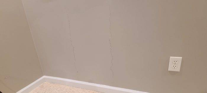

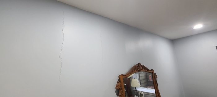

A few years ago, we had a company spray closed-cell foam into our already finished exterior basement walls. Construction is 16″ OC steel studs covered with 5’8″ drywall, taped, mudded, and painted. To get access, we cut an ~18″ high opening in the drywall midway up the wall around the outside perimeter of the basement. Company then sprayed foam into each stud bay, filling from the top down and the bottom up.
After giving the foam a couple of weeks to cure, we patched up the 18″ opening and repainted.  Within about a year, the walls all started to expand and bulge along each stud. Some of these “bulges” stand at least 1/2″ proud (or more) of the surrounding area.
I’m debating the best strategy to correct this damage.  I thinking I will knock down the highest spots, cover in FibaTape Crackstop mesh, and skim coat the entire wall. Thinned compound applied with a roller and then skimming with a 32″ blade.
Thoughts? Better ideas?
